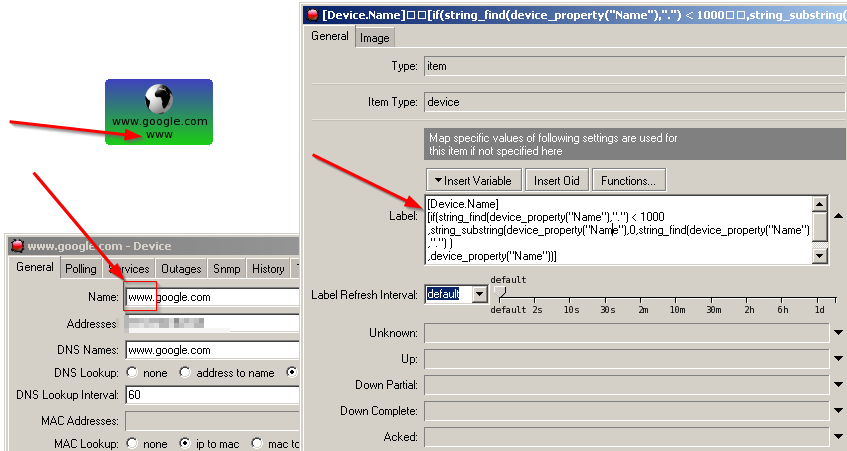

It’s not to complex to make it show what you wish. 7 minutes for solution :slight_smile:
The code for device label should be
[Device.Name]
[if(string_find(device_property("Name"),".") < 1000
,string_substring(device_property("Name"),0,string_find(device_property("Name"),".") )
,device_property("Name"))]
[device_performance()][Device.ServicesDown]
Well it was over a year ago and I wanted to get other stuff working. I thought about it last night and was thinking something like you did could be done. :slight_smile: You always have great solutions, thanks again gsandul.
Whoa…I would have never come up with that. I’ll plug that it and give it a go. Thanks for your post!
