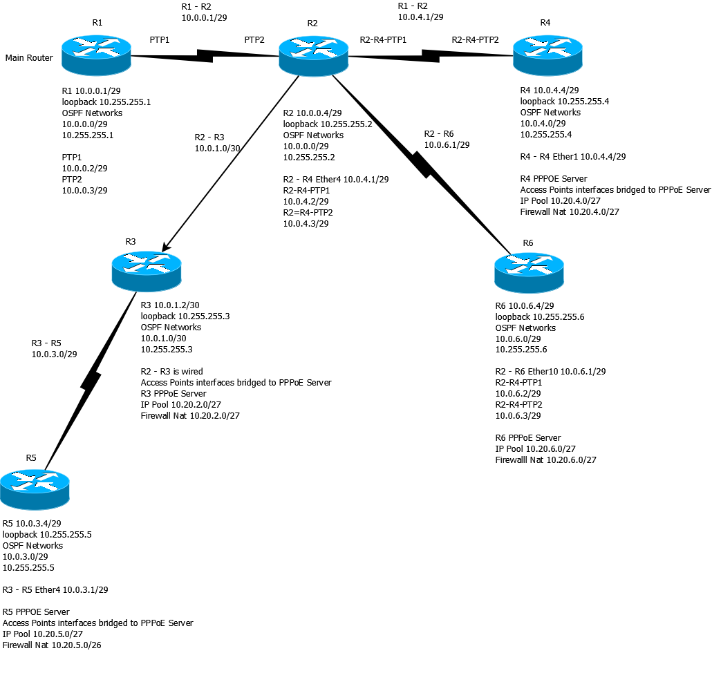

I’m having issues with my network, if anyone can take a look at the design layout and may be able to help with below issues.

R1- CCR1016-12S-1S+
R2- RouterBOARD 3011UiAS ROS v6.42.11
R4- 2011UiAS ROS v6.42.11

PPPoE terminations are on routers close to clients, no PPPoE server on R2
Client on R4 CPE connected to PPPoE. Bandwidth tests to R1 show 20M but on speedtest.net show different results, up and down to 10MB.

PPPoE server on R4 see image attached
I left MTU blank on the pppoe server.
