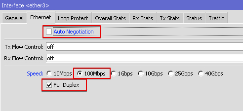

If for some reason autonegotiation doesn’t work you can set the speed manually.
How exactly I am supposed to set the speed manually?
