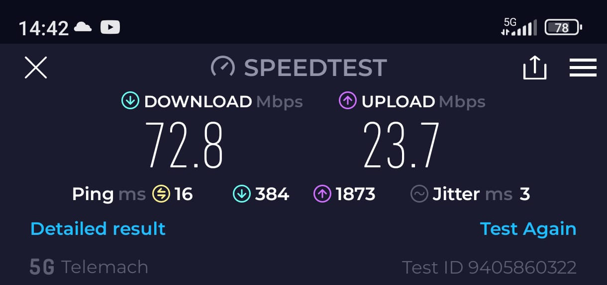

My results:
Without VPN, 5G network (rural area):

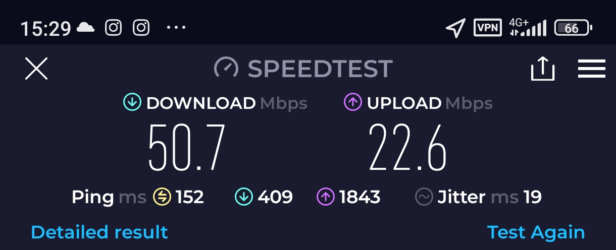

With VPN enabled:
Home internet speed is 170/140 Mbps so there are no bottlenecks on that side
If your router is behind NAT (no public IP), the connection is going through our Relay server in Latvia (for now our servers are only in one country). This is why the speed is different.

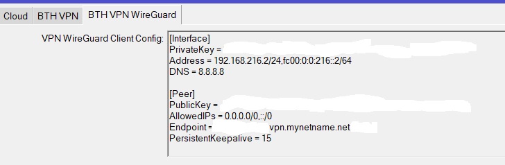

What are allowed IPs ? You should have 0.0.0.0/0 to be able to access internet through your RB5009 when connecting with a client.

-the suggestion regarding 0.0.0.0/0 was the winning tip!! So, in WinBox, WireGuard → Peers menu, there are two peers here. I’m seeing one with comments regarding my Samsung phone, so that’s clear. The other one is called ‘back-to-home-vpn’…so I’m guessing that’s some sort of default peer that was automaticly created by the new BTH functionallity?
In the Samsung phone peer, strangley there was only one row with Allowed adress: 192.168.216.2/32. I have added a second entry here: 0.0.0.0/0 I’m asuming that’s whtat you ment… :slight_smile:
That did the trick! After connecting with the BTH app on my phone, i can open the MicroTik Pro app now succesfully! Thanks!

Your client should have 0.0.0.0/0 in allowed addresses, you need to check that.
I don’t have 0.0.0.0/0 anywhere in router settings as far as i can see, only in client config so you should leave it as is.
You can always try with wireguard app, scan qr code and that’s it
I tested a little bit right now and i can access my devices without a problem.
You should export your configuration, remove sensitive data like public keys etc and post it here so someone more experienced may help you, but as i said, i didn’t make any additional changes, it worked out of the box.
You should have something like this:
