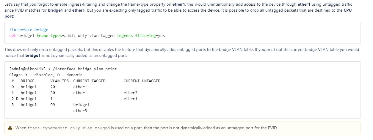

Reason for tagged and untagged access to device is your bridge vlan configuration, currently it is on default which is “Admit all” frame types
The “bridge” interface provides access to the CPU, i.e. the Mikrotik itself. As per the artile you quoted in OP, if you change the setting to the below it will correct this.
add frame-types=admit-only-vlan-tagged ingress-filtering=yes name=bridge1 vlan-filtering=yes
Above explained here in article you quoted / followed

As I said in my post, the “bridge” interface provides access to the CPU, i.e. the device itself, you have:
/interface bridge vlan
add bridge=bridge1 tagged=bridge1 untagged=ether2 vlan-ids=1
add bridge=bridge1 tagged=ether2,bridge1 untagged=vplsTunnelXXX vlan-ids=4
add bridge=bridge1 tagged=ether2,bridge1 vlan-ids=11
add bridge=bridge1 tagged=bridge1 untagged=ether3,ether4 vlan-ids=2
So all these vlans have access to the device itself. If these vlans need access to the “Bridge”, for i.e. pppoe termination, or DHCP, etc, only you can tell.
So if above is the case, then you must create a “Management Vlan” and add “Management Access Limits” using Discovery, Mac-Tel, Firewall rules, etc
