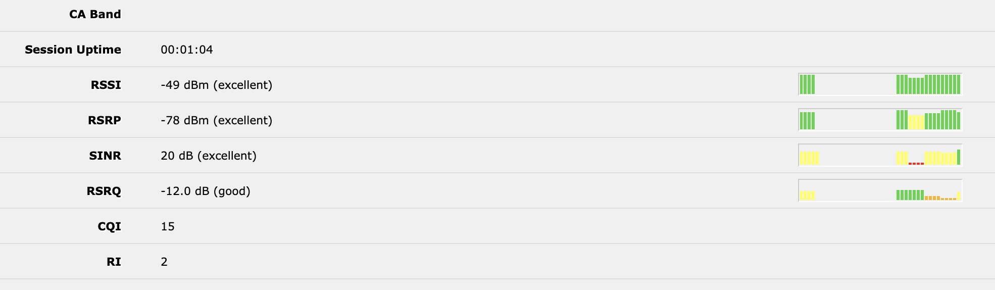

I’m running a Chateau 5g on 7.4rc. Last night i successfully installed a newly available firmware upgrade RG502QEAAAR13A02M4G - but it looks like this has completely broken my 5g connectivity.
It does not establish a 5g connection at all (I am very close to the base station and using directional antennas), and every 30 seconds or so it tries to re-establish the LTE connection that is available. See screenshot which shows the pattern. I tried a software reset with no success. Downgrading to 7.3x did not help.
Is there a way of downgrading the firmware on the modem? Is anyone else seeing this?

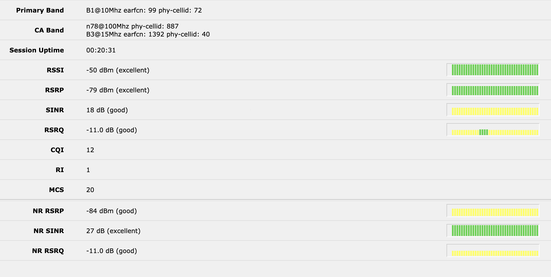

For comparison, here is my normal connectivity (taken a day or so before).
