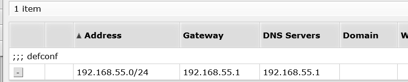

Go to IP DHCP-server Network and add 192.168.55.1 as the DNS server.
OK, I have added the DNS server to the entry that was already present under “IP=DHCP server-Networks”,
Hope this what you meant.- thx
Yes, this is what was missing. Probably because you changed the network address.
