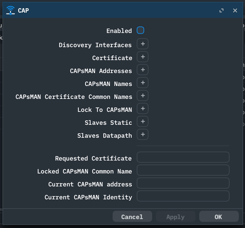

Another concern I have with combo device is how to place wireless part of it into Caps mode
That's not really an issue if you stay within the same wifi technology ( don't go mixing wireless and wifi or it may become problematic).
Yeah, I learned that the hard way. I wish they used more distinct names like WiFi-AX
What happens if you system reset crs418 into CAPS mode
Will it simply bridge all interfaces
I doubt you can do that on crs device ?
Care to try and let us know ? ![]()
If you reset device into whatever, then your config is toast anyway ... in that case "default" CAP mode (which might not be available on CRS as @holvoetn already noted) would be as bad as any other default config.
