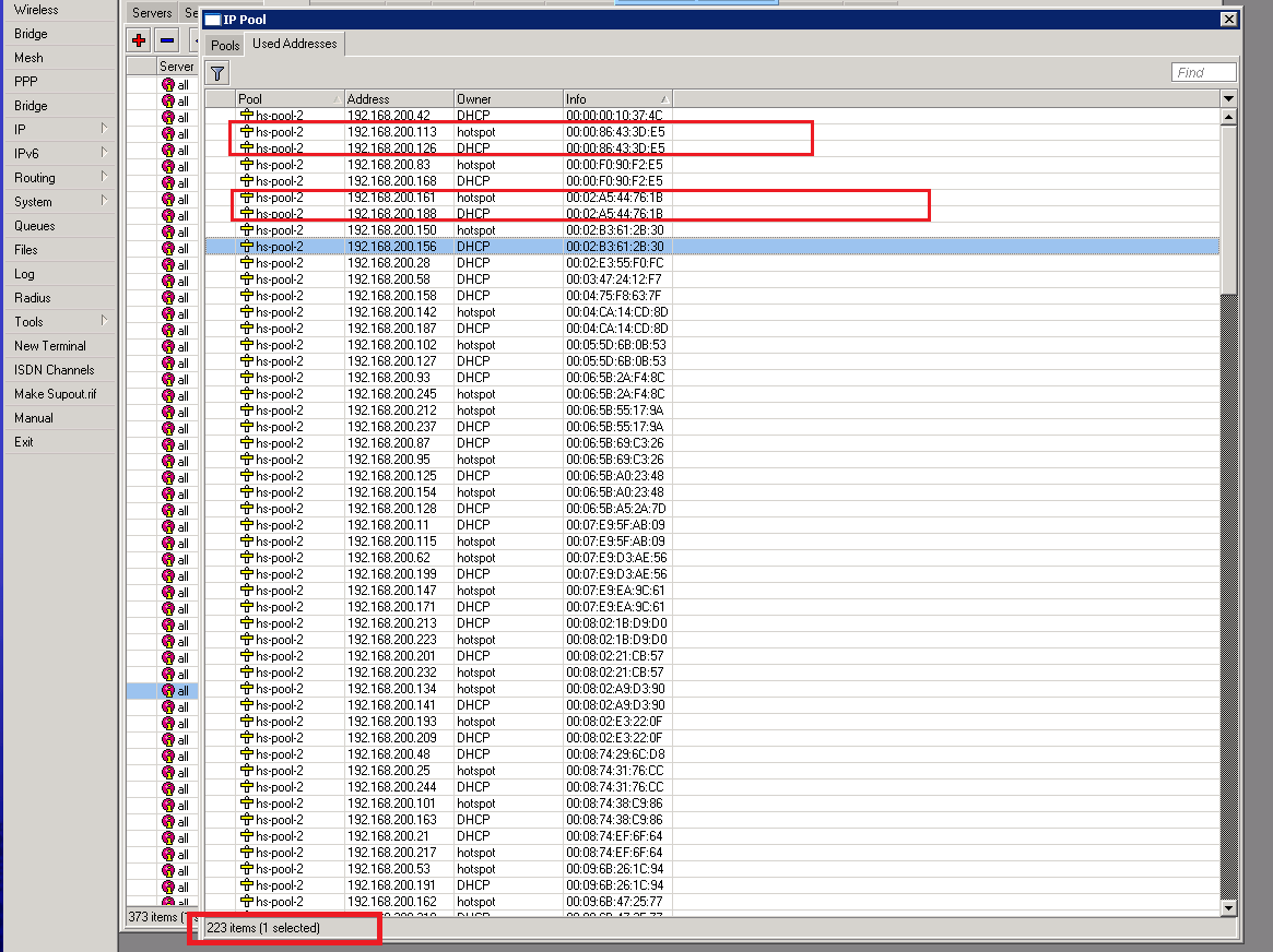

actuly in address pol one ip is reserve for DHCP and other ip reserve for Hotspot
in hotspot i set address pool to none. so that my ftp trafic on the network wilnot disturb.
see the bellow screen shot. in this screen shot there are 223 ip address are isued and i have few remain.
is there any solution? what to do for upcoming problems after ending the addresses???
