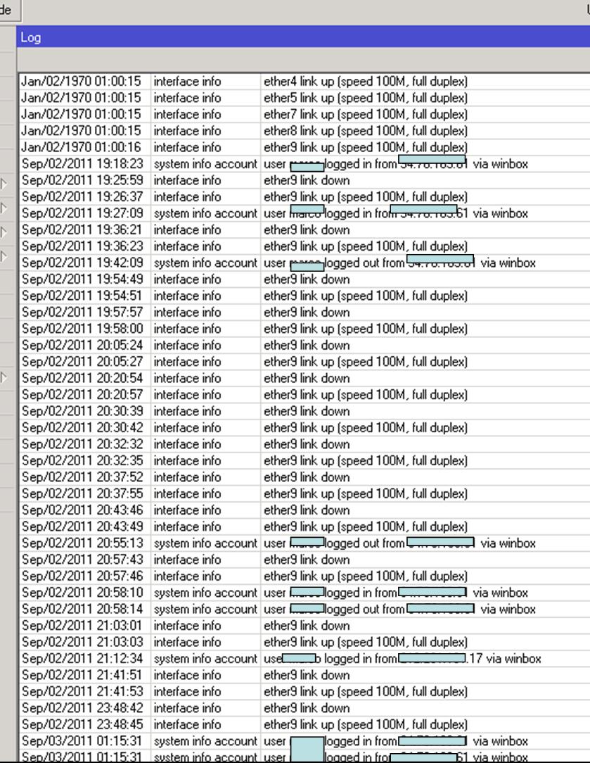

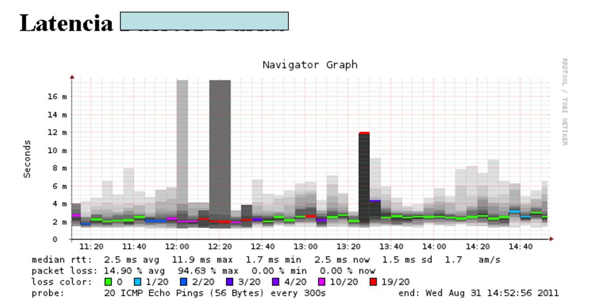

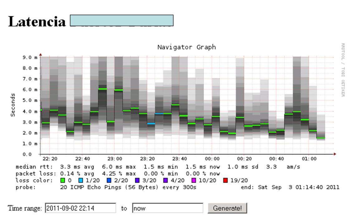

Dear
Mikrotik Forum
I apologize for my write but its 1:31am 03/89/2011.
My scenery.:
Main Router (OSPF) — RB1000(switch)/routing --RB433AH(PtP)/bridge – RB433AH(PtP)/bridge —RB1100AH(PPPoE)/OSPF— RB493AH/Bridge 5 port (where is connected 4 AP) — RB433AH/Two Radios/Bridge—End
Ten days ago after to upgrade all our Mikrotik equipment two 5.6V we note that one AP have to many drop and disconnection and over the RB493AH I see the ether9 down/up.- On this moment we reported to Mikrotik this problem and they recommend to me that Enable/RSTP on Bridge port because they think that the problem was a Loop.
A.- I enable the RSTP but the problem continue
B.- I read it on this forum that maybe the problem was the ethernet cable (I changed) but the
problem continue
C.- I change the RB433AH on the AP and the Radios but the problem continue
D.- I change the power supply and Poe and the problem continue
You can see my graphic where you understand that every 5 or 10 minutes the AP disconnect from the RB493AH by 3 sec and after come back but this problem affect to all client that is connect on this AP.
I spoke with the MT specialist on Mexico and he recommend that we need to add the mac address of our client on the access list, at the same time I ask to Janis/Mikrotik about it and he sent me back and email recommend that we need to do this.
Well yesterday 02/09/2011 aprox 23:00PM I added the clients that connect to this AP on the access list and right now 2:00AM on 03/09/2011 I not have the flap problem on the Port9.
I dont know if the problem go but I will be post on the next 2 days if the problem is 100% is fix it..
I hope that this information help you..
