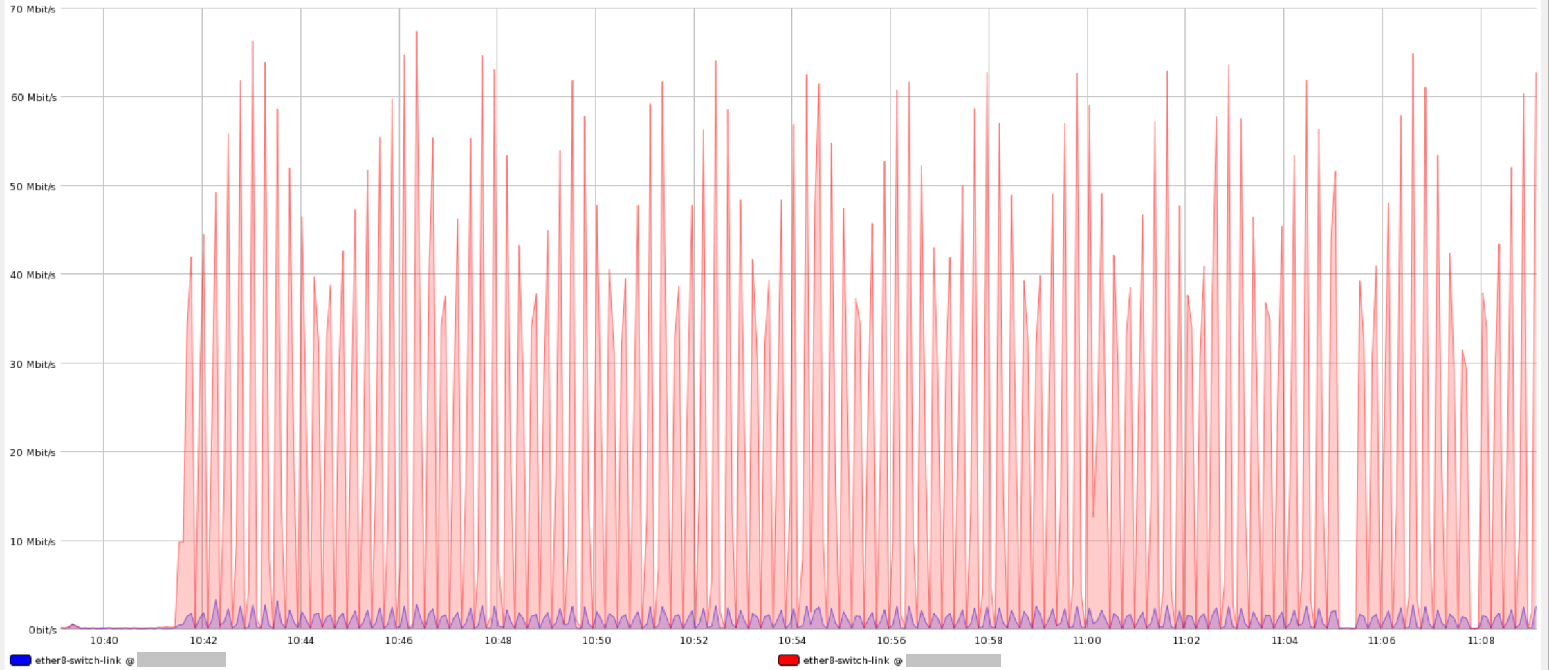

After connecting a new SMB share with about 50 files, a file tree is loaded pretty quickly, all files are visible in WinBox, but then RouterOS starts doing something weird. It creates a huge load on a network and eats a lot of traffic from SMB server. Within about 30 minutes it has downloaded about 4.5 GB of traffic from the server. And this never stops until you dismount your SMB disk. What the hell is it doing? (TILE, 7.18beta4)
On the Dude graph it looks like this:
Regarding woking with large amount of files, I often hear that you are improving the behavior for this scenario. But it will never work normally with large amount of files in current implementation. The reason is simple: RouterOS scans a whole file structure completely. If you have 10K files, 100K files, it will uselessly scan all these thousands of files, creating an unneeded load on network and server. And this process will begin over and over again after each reboot.

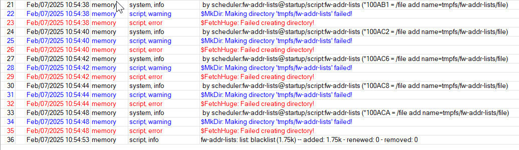

this sccrenshot was made on a rb5009 with ROS 7.18beta4.
The failed script in the sceenshot downloads FW blocklists, merge them and create list entries.
To do this, some files (size <200kb) are downloaded, stored in “Files” and after creation of the “Address List” in the FW menu these files were deleted.
It runs fine on every ROS before ROS7.18Beta2 and now Beta4.
The script itself is provided by eworm.
(please see at https://git.eworm.de/cgit/routeros-scripts/about/)
Please look at it, thank you!
Wait… What!?
So find is aware of the file and returns an id. But remove still can not remove it. Does that require a path now, for a unique id?
:local FileID [ /file/find where name="file/with/path" ];
/file/remove path="file/with" $FileID;
:zany_face:
That’s bullshit, no?
Please have another look at that.
We can’t replicate what you are saying, but actually it would be better and more correct to do it this way:
/file/remove file/with/path
and not
/file/remove [ /file/find here name="file/with/path" ]
All that fails the same way. Not every time, but way too often.
As this is racy you need to remove a file that’s not too old. Perhaps I should open an issue and provide more details… The problem is that behavior on racy things changes all the time, so there is no perfect reproducer.
yes, please make a ticket with details how to replicate, how many files you have, which file you removed etc.
