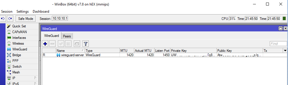

Wireguard apparently not supports MIPS architecture. Probably I’m wrong.
There you are wrong. Wireguard works fine on the RB750g3 Mipsel.
Quite true.
Hex (MMIPS) was my first Tik and the very first I used Wireguard on, already with first beta of ROS7.
Also on Map and mAP Lite (MIPSBE, 2nd and 3th Tik
) it works just fine.
Oh, thanks for clarification Jotne and holvoetn, so, only waiting for BTH compatible with MIPS.
