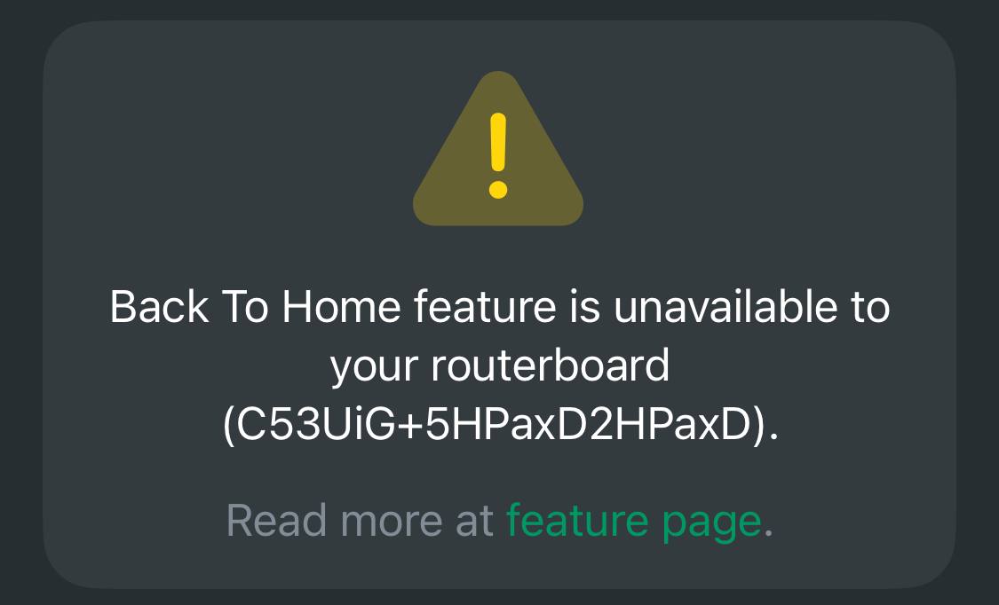

don`t working on my hap ac3 with 7.12rc1
Normal.
Wait for 7.13 beta or use 7.12 beta 9.
Feature has been disabled in rc and stable.
ROS 7.12beta9 + WinBox 3.40
