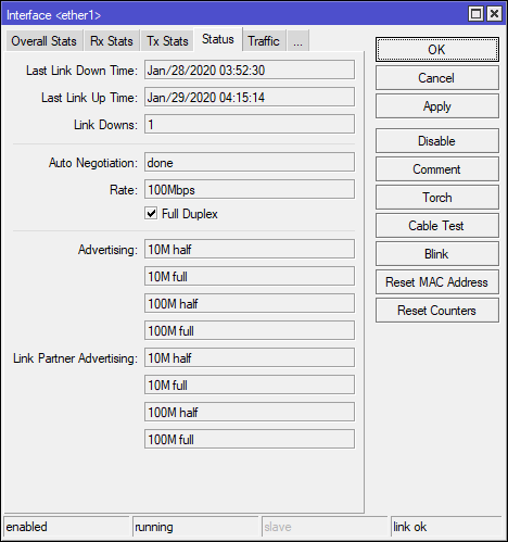

Maybe you have problem with Auto-negotiation ? Please connect lgh with few ethernet device like switch/pc/router and check in log’s the ethernet speed.
Good way is check this and show us your’s:

If on other
you have the same results then USE WARRANTY from your distributor.
This is not a magic, it’s should just work.
