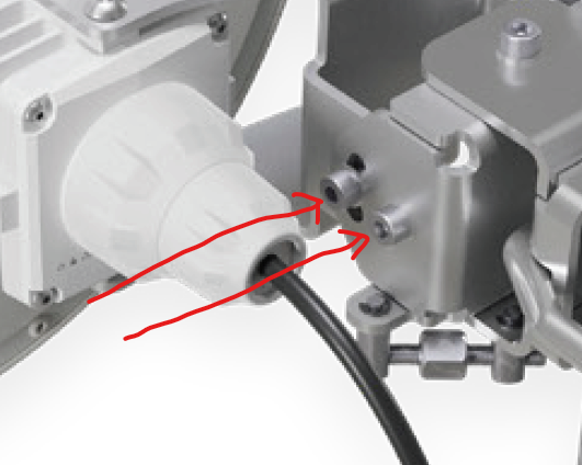

How are these screws accessed for aiming (It appears the gland seal is blocking access)?

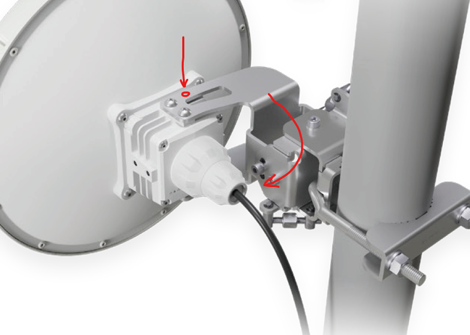

It seems there could be an additional hole to allow rotating the mount and reducing the front-to-back dimension. It appears this would have more clearance for those screws from the previous question. Any thoughts?

uberdome, the ethernet protection gland should not be plugged in yet, it can be on the cable, while you do the adjustment. After done, just slide it forward and screw it on

I accept that this can be part the installation procedure, but I have not used this style of MikroTik gland seal so I do not know how far it extends. It seemed like a reasonable question. Further, we don’t have any radios in our system currently that require partial disassembly of the radio or seals to be able to aim them. We normally complete the radio assembly entirely and then make adjustments.
