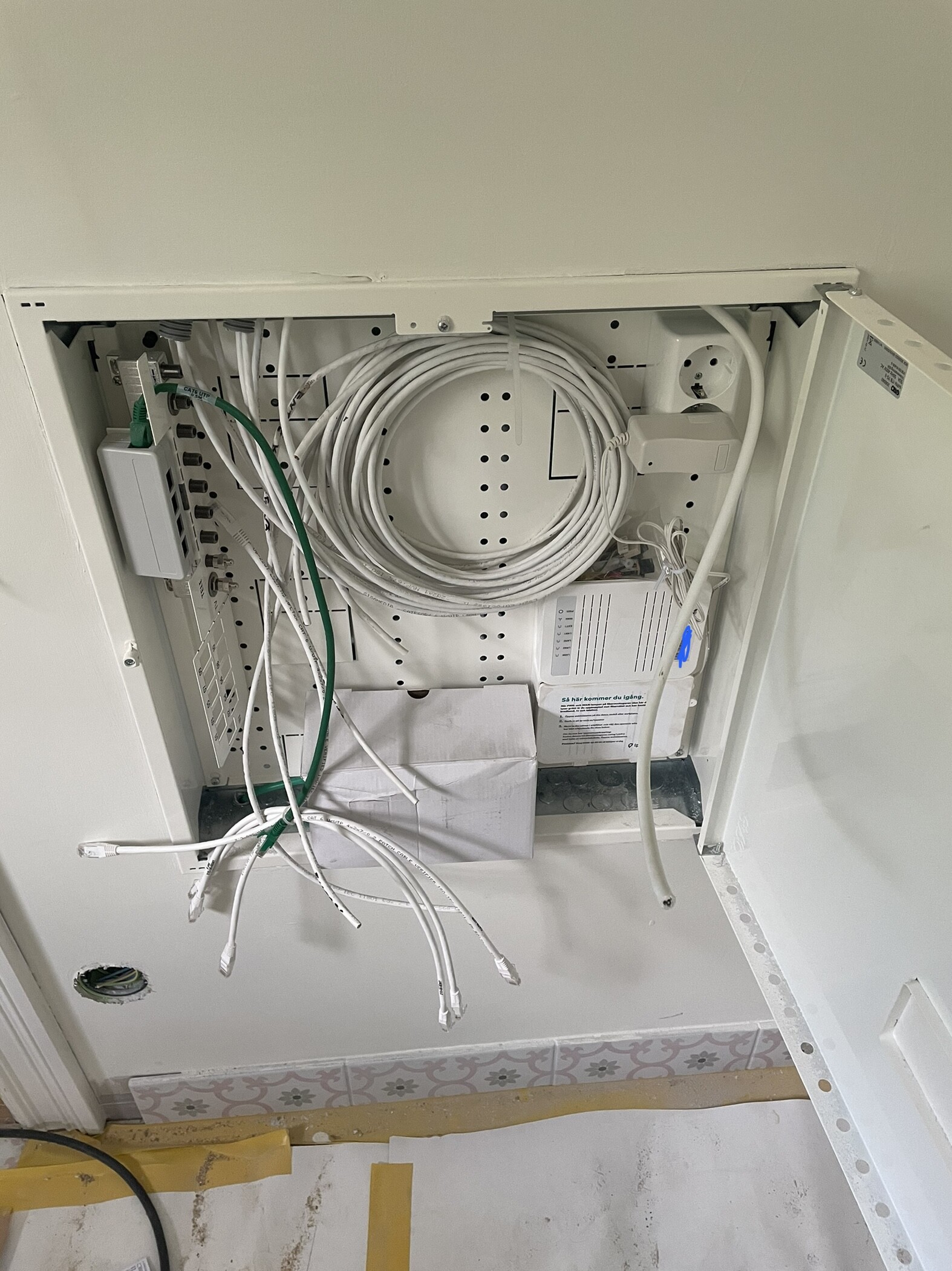

I came across the TP-Link TL-SG1008MP. It has 8 poe+ ports out. So maybe one of those plus the hex? And then 3 cameras and 2 acesspoints. It would also probably fit in the cabinet. I removed the included connectors to the left.
