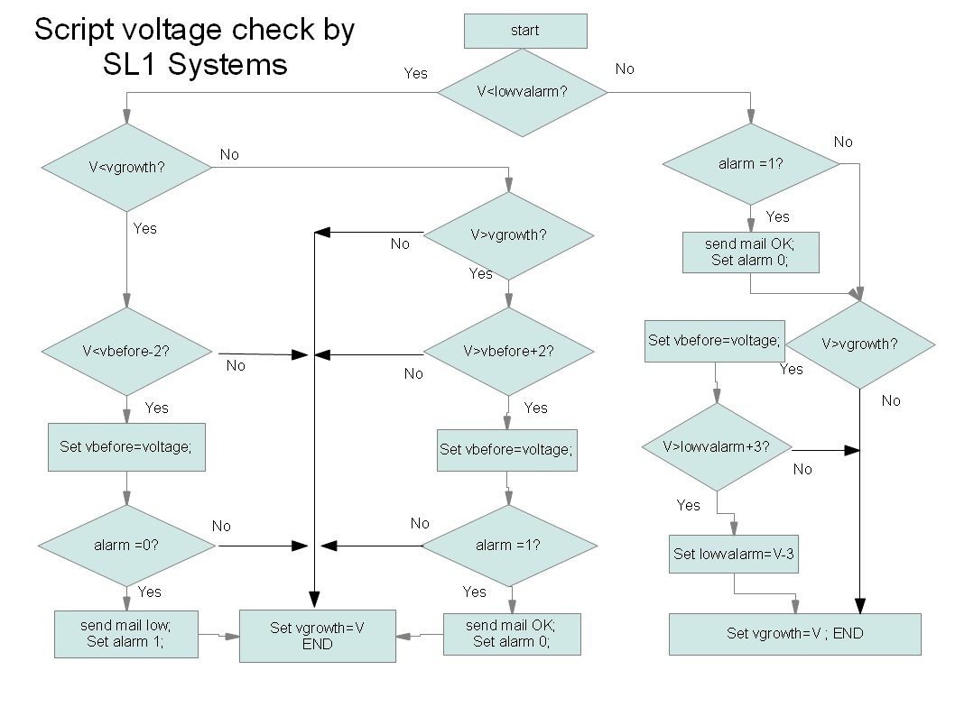

new low volt alarm script by SL1 Systems
This is a script made to check router voltage and send mail if abnormal state is reached.
It has to be scheduled every 15 or 30 mins after startup initialization script. It can automatically learn correct threshold
after the first startup initialization. So, if router starts on battery power, it will set the correct threshold after battery
fully charged and some auto-reiterations of “lowvalarm script”;
It can also discriminate battery low but charging and send OK mail till if battery isn’t already fully charged (but mains is present).
The startup-alarm initializes varibles and sends a “reboot” mail notice, so you will know if router has been rebooted because of battery completely discharged or every other reason.
I made a fully automated configuration script (.rsc) to set a router with all necessary things, which are:
  1. startup-alarm script; scheduled at startup only; it initializes all variables, included mail recipient
  2. lowvalarm script; scheduled every 15 mins (or 30 , according to your power backup time capability).
  3. set_mail script; to be run only once to configure “/tool e-mail” with your sender data.
  4. smtp_resolve script; to be scheduled every hour to resolve smtp domain ip address ad eventually update.
    So you only have to put your RECIPIENT address in startup-alarm script, SENDER data in set_mail script and SMTP server in smpt_resolve script.
    After those customizations, you can load the customized .rsc and you will obtain this behavior:
  5. script is loaded and set_mail, smtp_resolve and startup-alarm are launched in sequence;
  6. system will wait for 120 seconds (according to startup-alarm policy), and then send “reboot” mail notice;
  7. system will inform that script has been loaded and executed successfully.
This script can also be used with UPS power supply, without serial communication.
I explained here http://forum.mikrotik.com/t/supported-ups-s/44249/1 how this goal could be achieved.

I also made a flow chart to explain how lowvolt alarm script works. It’s attached here.
Is any1 currently running this script, and does this script still work in ROS 6.32.3+ ?
I’m currently running this script in lot of routers, with Routeros v. 6.32.2 .
Next days I’ll make 2 new installations, so I’ll test Ros 6.33.1.
OK, thx for info! :slight_smile:
I have had it a lot before that I try a script, just to find out there has been a change meanwhile in ROS so it doesnt work as intended!
Ill give it a try!
