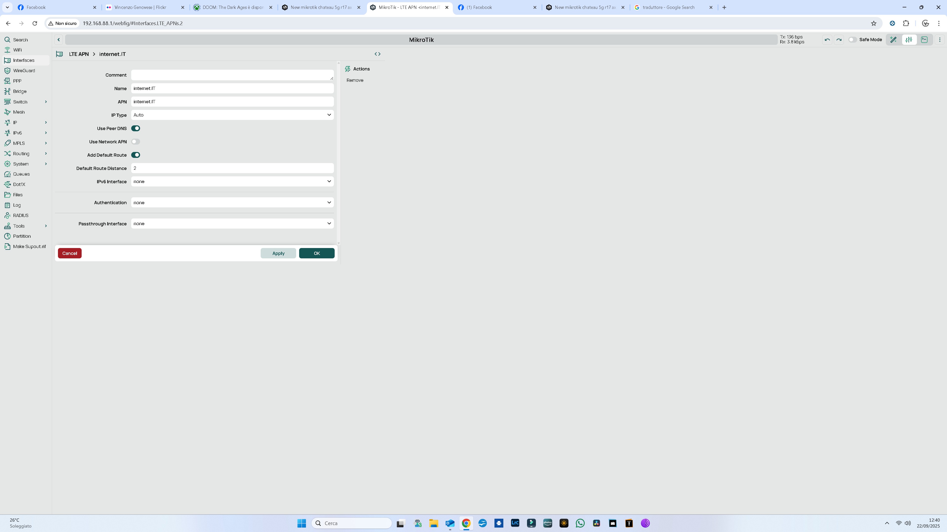

Not at all an expert in this kind of stuff, but your APN(s) seem off.
The APN for unomobile (which I believe is a MVNO woirking on Vodafone) should be web.unomobile.it or apn.unomobile.it
The APN internet.it should be that of windtre.
Which ISP SIM are you using?
Could it be that having two of them creates a conflict of some kind?
I added the Unomobile profile later to see if the problem was with the Wind/Tre operator, but the same anomaly occurs with Unomobile too, I have now removed it. In the APN you have the choice of activating or deactivating the "use network APN". If I activate it, I am connected to the internet but it does not load any web pages. If I deactivate it, the router works regularly, loads pages, etc., that's why I disabled it.

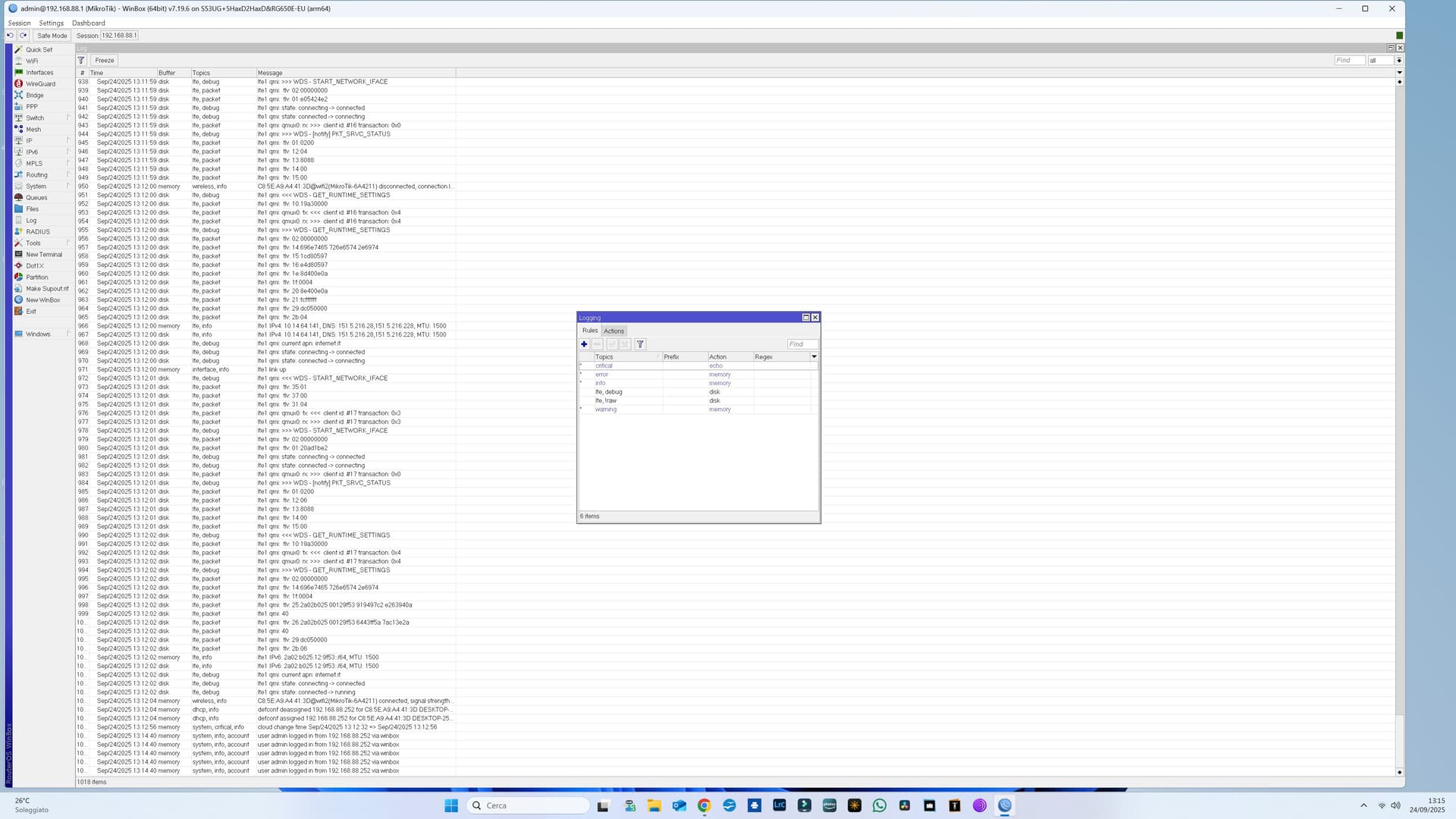

Hello emiltec,
Please use the support portal Log into Atlassian - Support and send us the supout file from your device with enabled lte debug logging. The router should be able to reconnect by itself.
LTE debug logging can be enabled through CLI by issuing this command:
/system logging add topics=lte,!raw
This article explains how to make a supout.rif file:
https://wiki.mikrotik.com/wiki/Manual:Support_Output_File
Hello, thanks but the link/ page:https://wiki.mikrotik.com/wiki/Manual:Support_Output_File
Wiki/Manual:Support Output File is empty
There is currently no text in this page. You can search for this page title in other pages, or search the related logs, but you do not have permission to create this page.
I referenced the old wiki page by mistake, here is the new link:
I entered the command and I think everything is set up well, at least I think so, as soon as the disconnection occurs I will generate the file

As the @emiltec I already setup the APN to “internet.it” and disable the “use-network-apn”. In the first run I had that enabled, but could not navigate elsewhere, so the decision to disable it.
I upgraded the RouterOS and modem firmware to the latest stable version yesterday, which was day 1 of my Mikrotik Chateau AX R17.
