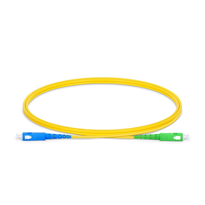

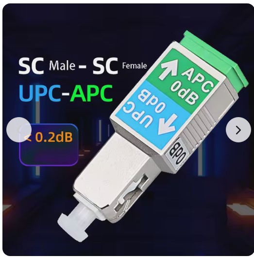

My GPON provider (which provides ONT as well ... and is not the same as ISP) terminated my FO with SC APC plug which then plugs directly into ONT's receptacle. So the adapter patch cord shown in post I'm replying to wouldn't work ... either I'd have to make GPON provider to replace plug with SC UPC one ... or I'd have to get an SC APC/APC adapter (and then use the suggested patch cord).

Yes, of course you need a SC/APC-SC/APC coupler if the connection terminated with a connector. In some cases ISP install a connector box. In general, switching from SC/APC to SC/UPC is a quite simple thing :slight_smile:
Meanwhile I found a simpler solution
