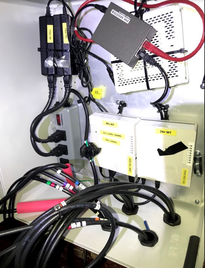

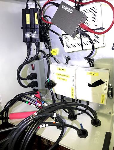

edit: ha, here is a perfect use-case of new of a box/setup we just deployed yesterday (yes, we will be re-doing that AC main power line, it was just temporary):
