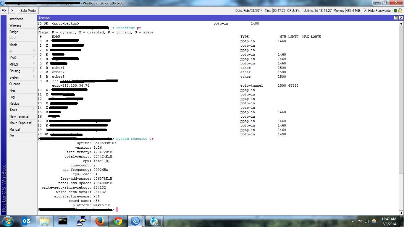

is L2MTU shown only on RBs?.. I don’t see it on my x86…

Helo All,
Why my RouterOS can’t view L2 MTU??
because hardware/driver doesn’t support that
