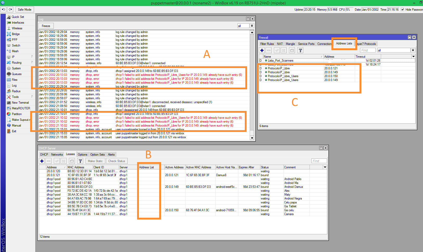

Now I am on 6.19 and after upgrading, now the Address Lists behaves strange, here attached a picture that will explain almost itself.

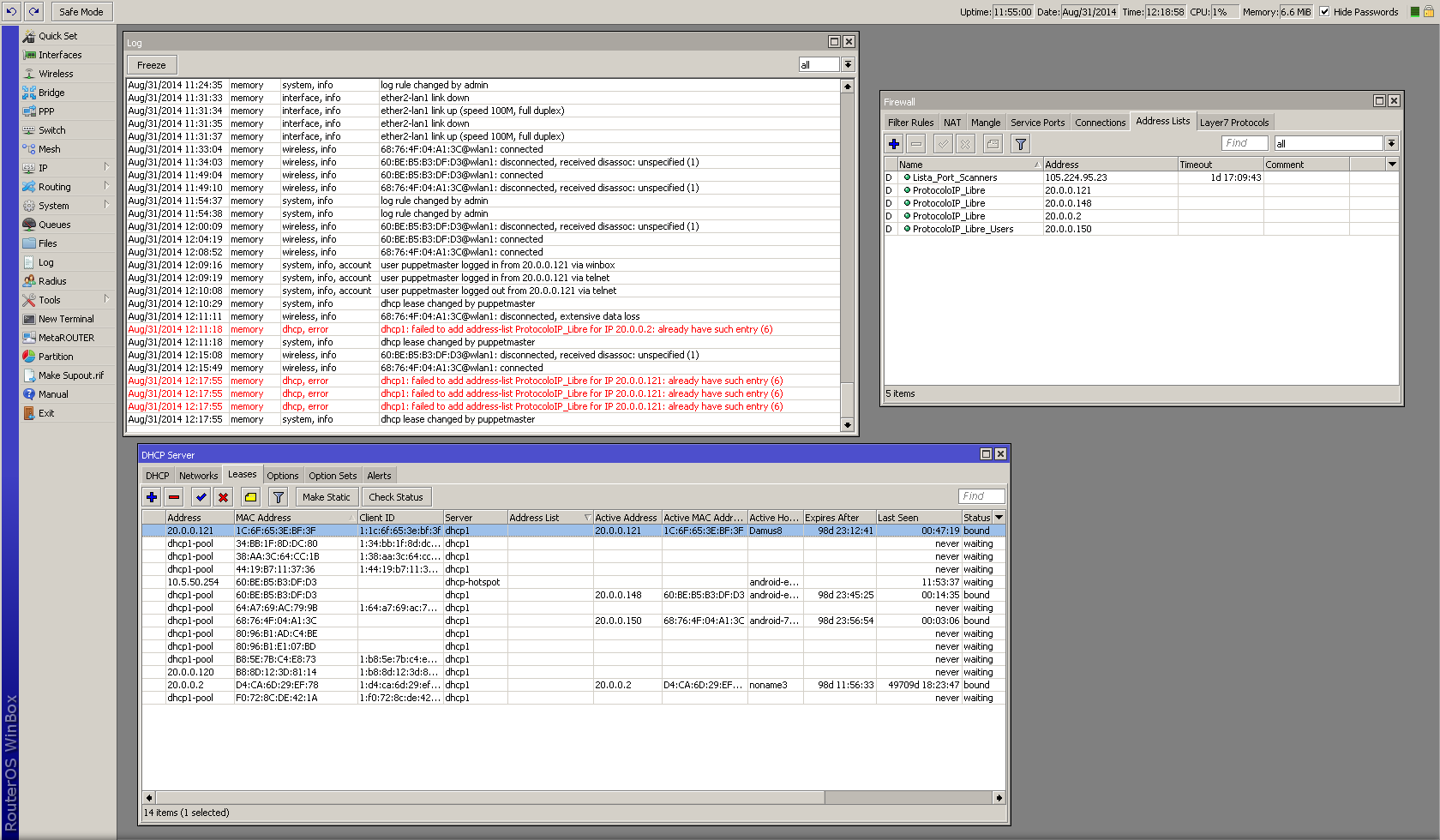

If you add the value to the Address List in DHCP Server (B), Leases, it adds OK, but you get an error in log (A), BUT you havent really any address list on Firewall, Address Lists (C). As you can see on (B) there is no address list defined but on (C) there are some dynamically defined… but they aren equal when they should because I assign them from DHCP Server (B). My guess, might be wrong, is that the address lists are “kept hidden” someway and that why the router gives the error log (A)
More strange is that after assigning Address Lists on (B), you get the log error (A), the lists save on Firewall, Address Lists… then after some seconds… I see DHCP Server, Leases, Address Lists column gets cleared, just as if some script resets them, leaving as you can see on (B). I have no scripts doing this kind of thing.
OK, I think I will delete every address list assigned to clear the values… so I delete every list from (C) and (B anyway its empty, I set it and delete it.)
So no values on (B) nor (C).
I set again values on (B), I let each PC on the lease to re obtain IP address, then I assign there each one to the Address List I want.
They appear on Firewall, Address list (C) as assigned dynamically.
I get the error on the log (A)
And the values disappear from column Address Lists (B) one by one :open_mouth:

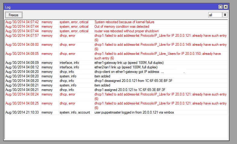

And to finish you get kernel failure after some minutes/randomly.

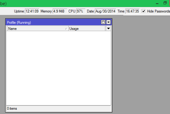

PD: There is a bug I think someone can confirm if they have 6.15+ versions… if you open Tools, Profile… you get a blank window and the router starts consuming the whole memory until it reboots, here a picture too (this comes from 6.16 if I remember well, same result from terminal…)
