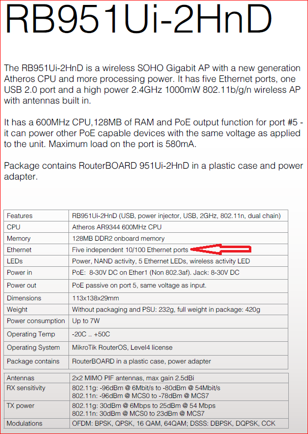

The RB951Ui-2HnD is a wireless SOHO > Gigabit > AP with a new generation
Atheros CPU and more processing power.
Five independent > 10/100 > Ethernet ports
Brochure is correct. Where did you see this? If on distributor site, we can’t correct that.
The link in the first post.
Did you try reloading? Because I don’t see this :slight_smile: You probably have browser cache
No I did not because I downloaded the brochure for the first time just before i posted. :slight_smile:
But this is correct, it has 10/100 ports, not Gigabit. Therefore it doesn’t have a “G” in the name. Nowhere in the brochure is Gigabit mentioned :slight_smile:
It says Gigabit AP in the description and that is a contradiction to the specification.
The RB951Ui-2HnD is a > wireless SOHO Gigabit AP > with a new generation
So the bug was there. I didn’t notice that :slight_smile: Fixed.
