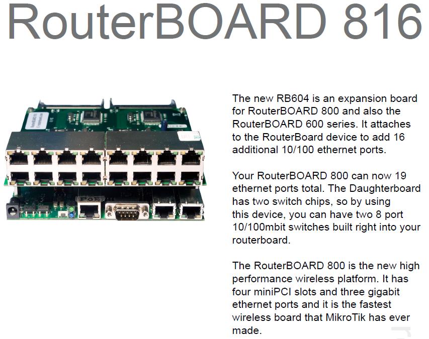

In looking at the RB816…
I looks like the system communicates to the Ic178C switch chip via an Infinion an983b. ethernet chip, with the IC178C running in a 8+1 port configuration.
This would mean that the 8 ports “share” a common 100Mbit link to the PCI bus.
SO… that would be 100Mbit port to port, but a shared 100Mbit link back to the CPU.
Correct ?
Am I the only one not quite getting the point of this board? How, exactly, are we supposed to use a 19-port router? Yes there’s the switch chip, but aren’t there enough 16x10/100 + 1xGigabit L3 switches on the market already?
If csickles’s observation is correct, this means that it’s essentially a glorified hub. You would be better off buying an el-cheapo Chinese pseudo-managed switch.
Most importantly though, how is this more important than an SFP port on the high-end RBs (RB600/800/1000)?
I’m looking forward to hearing about any uses for this board…
Have to agree with “andreacoppini”,
I’d prefer more Ports for RB 1000U, or the daughter board made to fit in a 1U casing, using interface / data cable.
RB 816 looks abit bulky to fit in any network server condition.
(While RB 1000u too empty inside the casing :smiley:)
That’s only my opinion..

Do all of the ports on this show up as configurable interfaces on routerOS or is it just basically a switch?

I agree with some comments here - this set has really stupid size. Solution that many of us neer is 1U router like RB1000 with more ports.
Casing IS important, when you ar not using it for own usage, but placing it in customers rack! Many routerboards look like “home made” and not reliable for non-IT customers.
