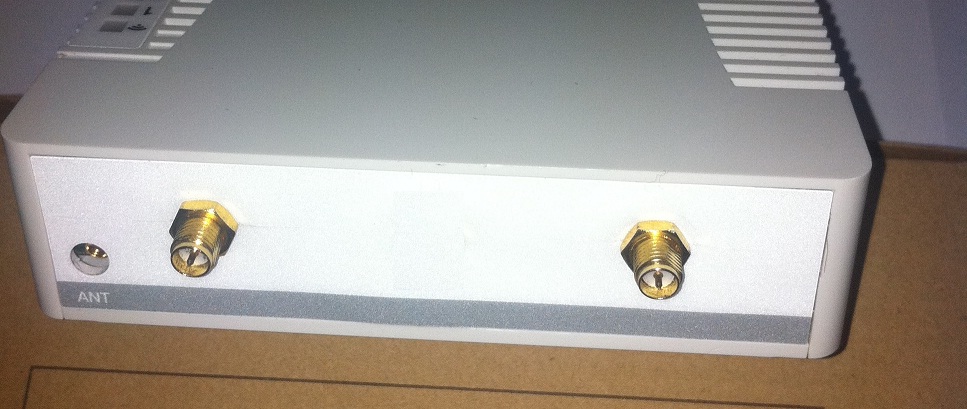

1 port POE out and RSMA conektors on the back = ideal wifi router

Hi honzam.
I have a couple of questions.
First, are those RP-SMA connectors already in the router or you added them?, and if you added your own SMA connnectros, please could you give us an image of internal connection, just to know where to cut the circuit for optimal impedance. If you don’t take impedance to be adapted, there will be power loss in antenna.
Second, may I use RBGPoE adapter/cable from MikroTik to power this router?
Thanks in advance.
Any suggestion is welcome.
Regards,
Alex
See this link http://forum.mikrotik.com/t/wow/552/1
Yes, gigabit poe injector you can use.
