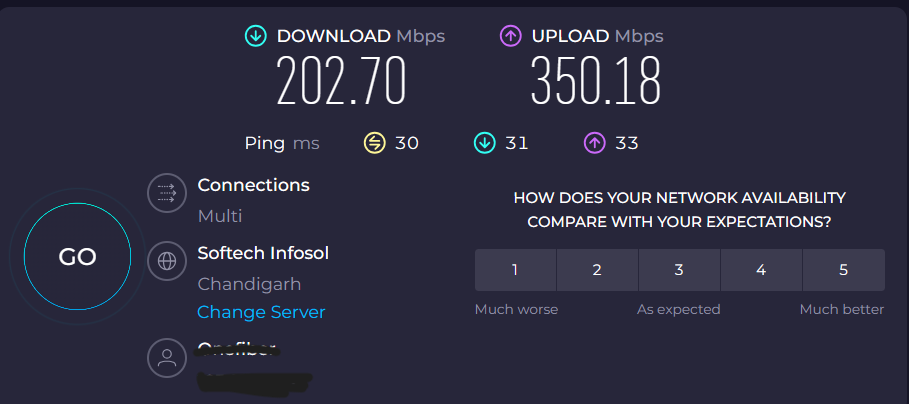

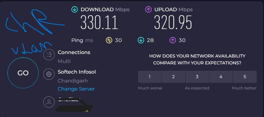

i have an internet at 320Mbps up/ down i though i was putting junk into the 750gr3, its about 5 years old daily/night on and i just formatted it and made simple program just to route the internet. i see low speeds. this use to work great when it was in 6 version now this has latest 7 version.
i also re did the firmware but still same any experience in that??
in 750gr3 the 200 is achieved in a slow rising graph while in chr the needle hits the 340 goes to 430 then comes back to the desired 330

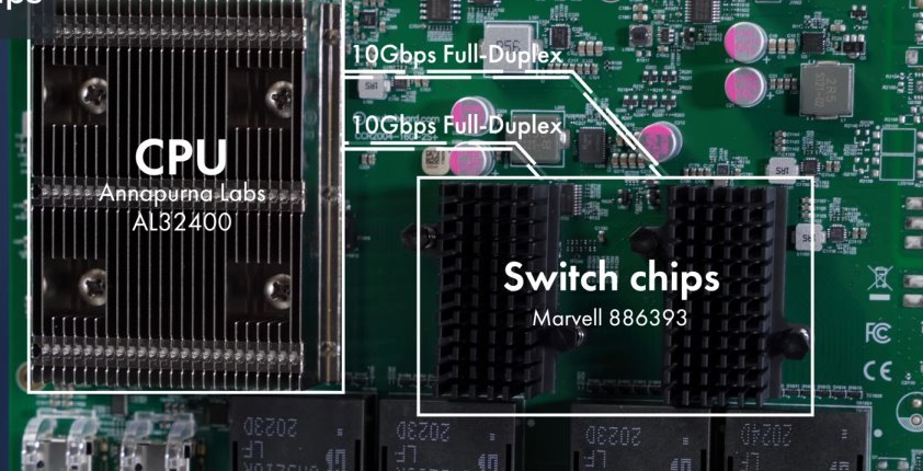

i think it must be the lan connection to the cpu

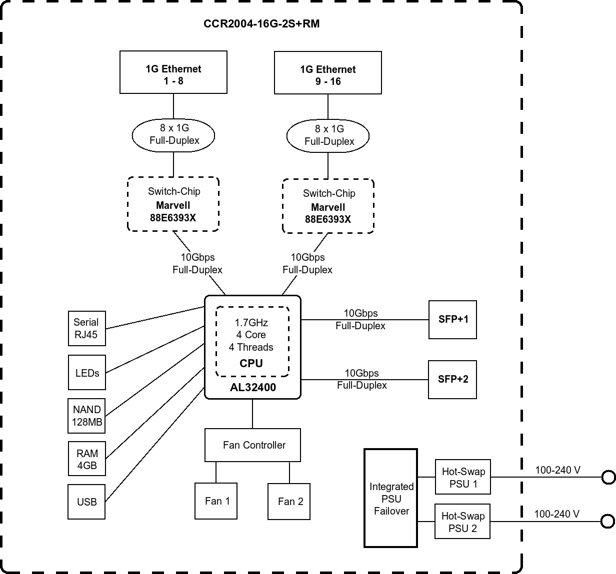

CCR2004-16G-2S+PC 1200 frequency one
Each group of 8 Gigabit Ethernet ports is connected to a separate Marvell Amethyst family switch-chip. Each switch chip has a 10 Gbps full-duplex line connected to the CPU.
ok so as per my resarch older ones have on emarvell chip vs new one having 2
so the difference must be single marvell vs 2 marvells vs better marvell chips connection to the cpu
ok so tried with a new 750gr3 and latest hardware version same speed 220up 350 down, came back to the old one downgraded too 6.49 and 290up and 250down.
back to my proxmox chr 340down 350up and the speed test needle rises in second.
