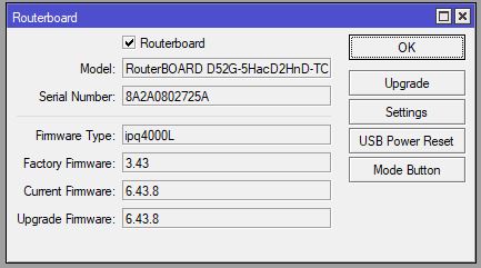

Hi.
Where i can download new routerboot firmware???
New hAP AC^2 have 6.42.3 factory firmware and my old hAP AC^2 have only 3.43 .
Thnks.
Upgrade RouterOS to 6.43.8.
Then in system routerboard → upgrade firmware → reboot
i need routerboot factory firmware:
Factory Firmware is what was originally loaded at factory. You can ignore this. Installed version is under Current Firmware.
Previously, it could be updated. Also in the new routerboot were made small fixes.
Your firmware is already upgraded. Move on.
