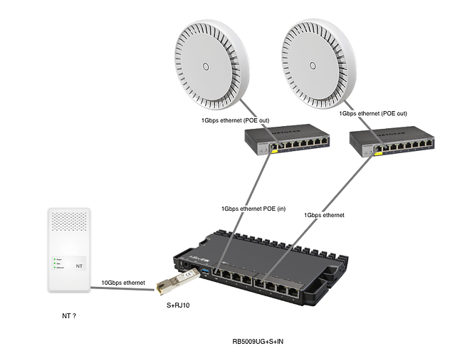

Or indeed the option of @victorbayas which will give you more speed.
RB5009 and multiple cAP AXs
I like this solution!
Probably adding a Mikrotik S+RJ10 to the RB5009. To allow the full 4Gbps bandwidth?
I can then extend/ upgrade the setup with a CRS305-1G-4S+IN and VLAN filter.

Roaming does not have to be instantly, does this change your advice. Other suggestions on the hard- and software are always welcome.
You need to understand that those ISP-provided boxes are dumb and limited, but they shine in performance. They run optimized software for the chipset, allowing all kind of accelerations that RouterOS is lacking.
To compensate for that, you need to buy higher-end MikroTik equipment than what the ISP is giving away for free (and cheap to buy on the market). An RB5009 is not so bad, but of course you will not be able to achieve your 4Gbps in a setup like above, because the RJ45 ports are not that fast. ether1 is 2.5Gbps but issues are often reported with that, so you need to be prepared that it would not negotiate 2.5Gbps in some cases. But in your case, you would have “only” 1 Gbps for each port, so only when 4 ports on the RB5009 are maxed out at the same time you can achieve your 4Gbps.
Also, you might already hit the CPU limit there. For example, PPPoE in RouterOS is software-implemented (the chips support hardware acceleration for it but RouterOS does not support it, the ISP white boxes do!) and you may see a single core maxed out when trying to achieve 4Gbps.

I was also looking at the CRS310-8G+2S+IN. According to the specs this CRS (Cloud Router Switch) supports RouterOS, and has 2.5Gbps ports. Or the CRS305-1G-4S+IN (approx. 130 euro) or CRS309-1G-8S+IN (approx. 200 euro) and the 10G SFP+ module (approx. 60 euro).
I can add two 1Gbps ethernet SFP+ (I think I still have wandering around) to connect to the switches and one S+RJ10 to connect to the NTU. Where I actually would prefer fiber to fiber and not fiber to network termination, but I don’t know the fiber specs I assume 1310-TX/1490-RX.
Do the CRS router/switches support the same feature set as the hEX-S I already own? :man_shrugging:
All MikroTik devices running RouterOS provide the same feature set, but the performance varies.
With CRS devices you have to know that they are “primarily switches that can do routing as well”, so a device with multiple 10Gbps ports can do switching between the ports at 10Gbps but not necessarily routing.
Always look in the details page of the product under “test results” and note the difference between switching and routing specs. The typical speeds a user can expect are the “routing with 25 ip filter rules” for 512 byte packets.
For the CRS310 you see that this is by far not enough for your needs.
