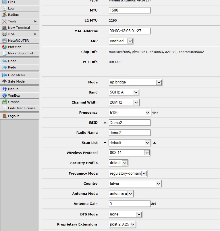

Number 2: (Tacking from the demo site) Under wireless in advance mode there is a field call Antenna Gain, what is that for? SEXTANT 5HPnD is 18 db antenna, do I put 18 in that field?
Number 3: (Also from demo site) Under wireless there is a field call Frequency mode, default it is put to manual-txpower, but what do I use it for?

antenna-gain (integer [0..4294967295]; Default: 0)
Antenna gain in dBi, used to calculate maximum transmit power according to country regulations.
I rely don’t understand this, cuss how dit dbi end up with transmit power? I say antenna-gain and my antenna is 18 db antenna, so do i need to use this feld?

Yes, if you put number 18. Then sextant reduce TX power.
Search for EIRP and see how it is calculated. Regularory limits are given in EIRP for most bands.
