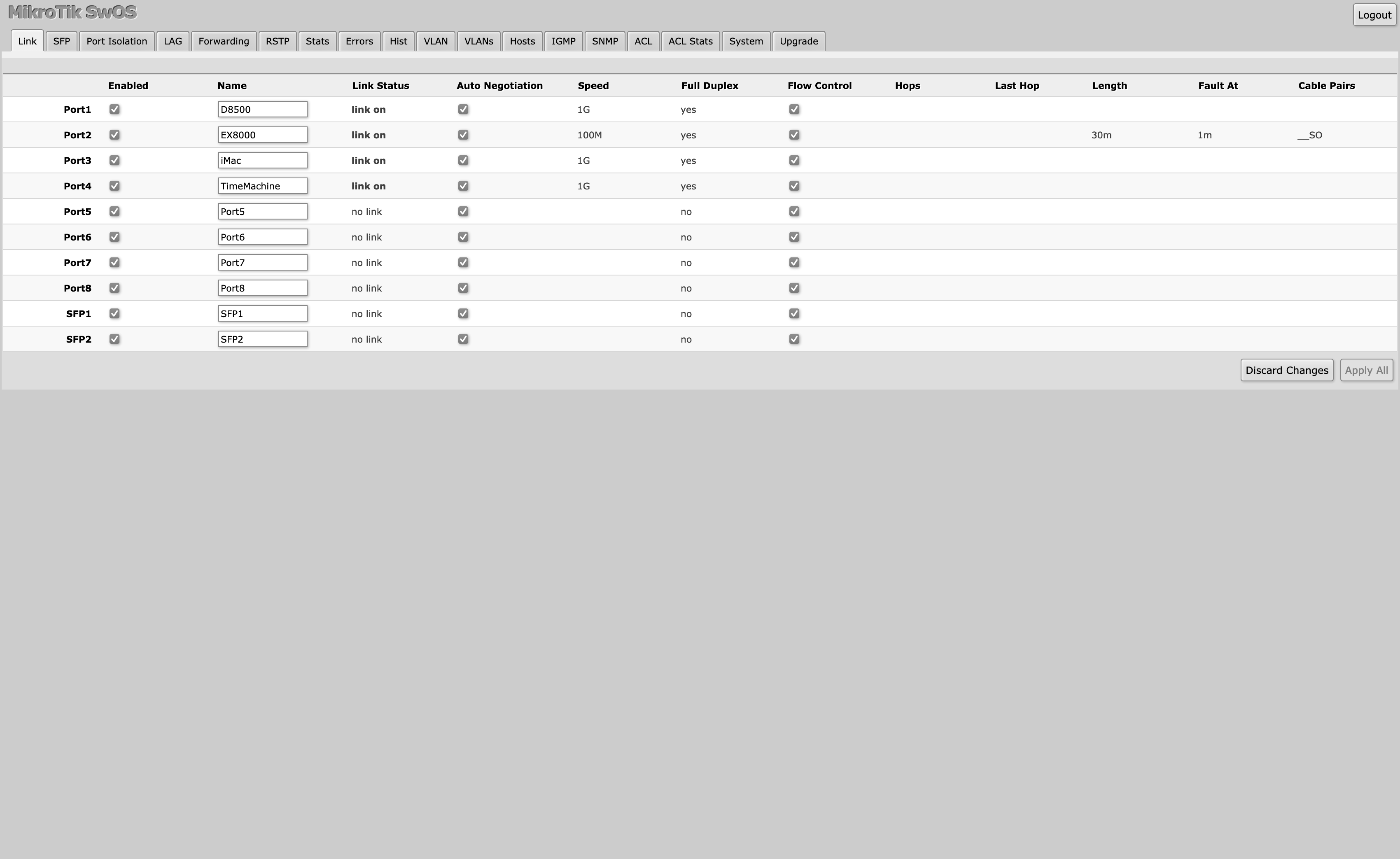

I can also say that the cable between the switch (or router) and the extender is long, and SwOS/Link says 30m, and shows some info in the column after flow control like 1m and _SO.

Just a screenshot update:
https://postimg.cc/tZQyGFNS
Could it be that CSS610 is much more ‘sensible’ to long cable than the router?
Well, in the end I removed Flow Control and set bandwidth to 100Mb. Connection seems to work exactly as with D8500.
