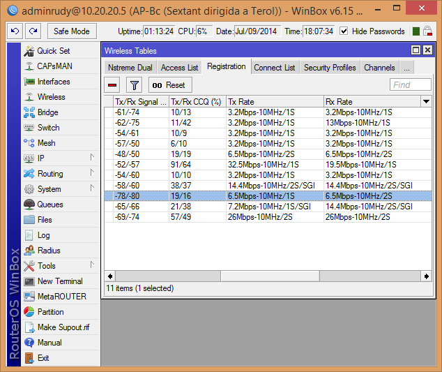

I would like to know “1S” or “2S” (probably 1 or 2 chains. But I see 1S on SXT’s that are are connected to a dual chain AP?)
“SGI” Could this be “Short Guard Interval” as opposed to the “Long-” or “Any Guard Interval”?

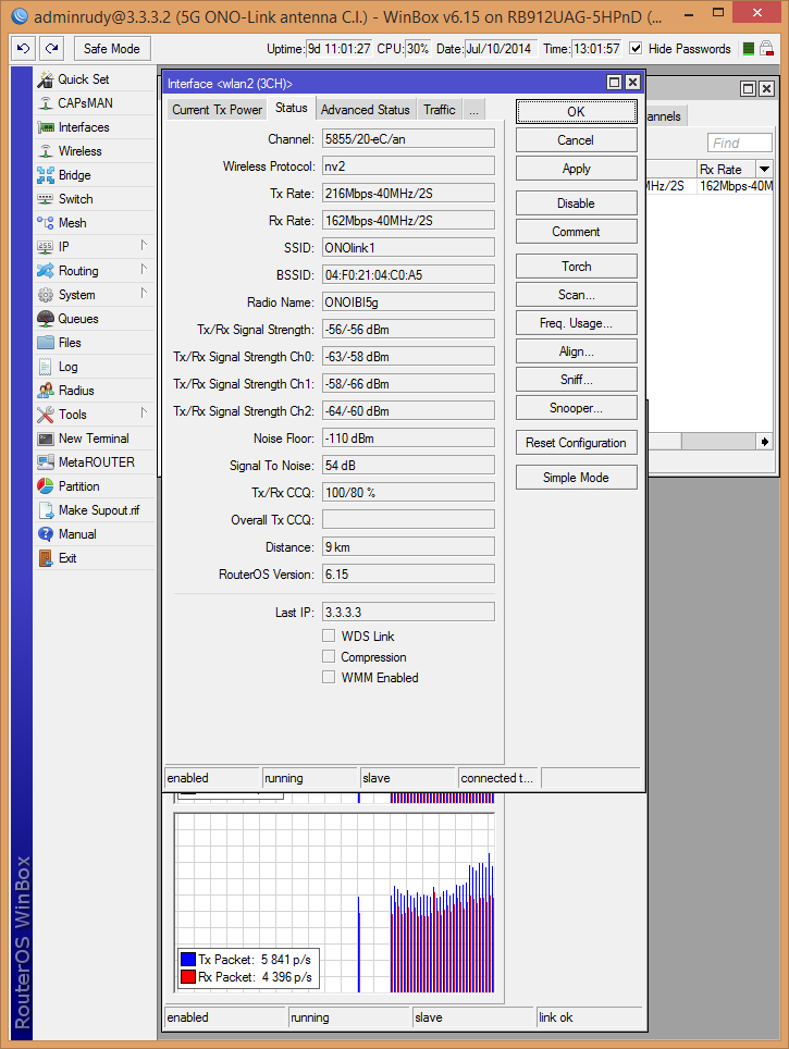

Ok, can anybody explain me why some CPE’s show the 1S or 2S alternating? Even with good signal levels for both chains?
I can understand that it means only 1 or two chains are connected. But with signal levels of around -55’s for some, why should antenna work only with 1 chain at times, to go to 2 chain, back to one, etc.. on both rx and tx independent from each other.
I have one other link working with actually 3 chains. Although the signals tell me all three chains should be connected (all three report levels better than -70)
the rates never show 3S. Only 2S.
Does this now mean only 2 chains are used?

1S or 2S means how many Spatial Streams are used. With that value you can know better which MCS is used.
https://en.wikipedia.org/wiki/IEEE_802.11n-2009#Data_rates
Yes, SGI stands for Short Guard Interval
If your link doesn’t use 3S it means that with 2S it can get better and higher data-rate without lot of retransmissions.
