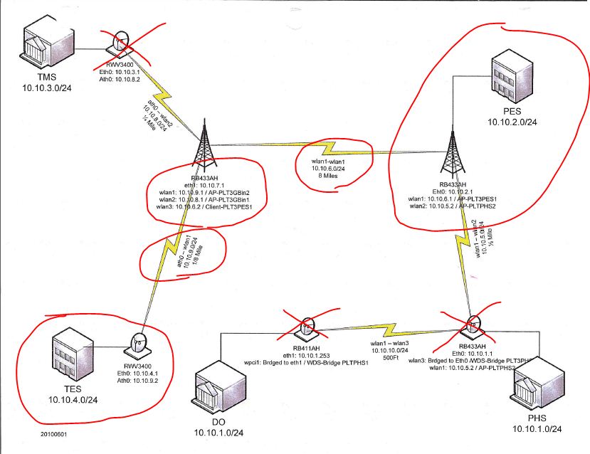

OK. I’ve compiled some information about the network. Here are a few images with some of the info. There are a few more screen shots I need to get and post, I should have those later today.
This is the map of the over all network. What is crossed out, is not longer needed on the wireless. Circled is what I am trying to get to communicate with each other. The antenna for PES 10.10.2.1 and the Grain bin 10.10.7.1 both are up and working, just not communication between the two.

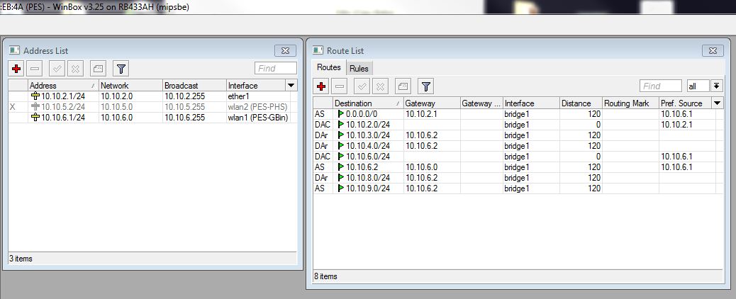

Here is the configuration for the PES 10.10.2.1 RouterBoard. I will post the configurations for the Grainbin and for the tower at TES 10.10.4.1 as soon as I get over there.

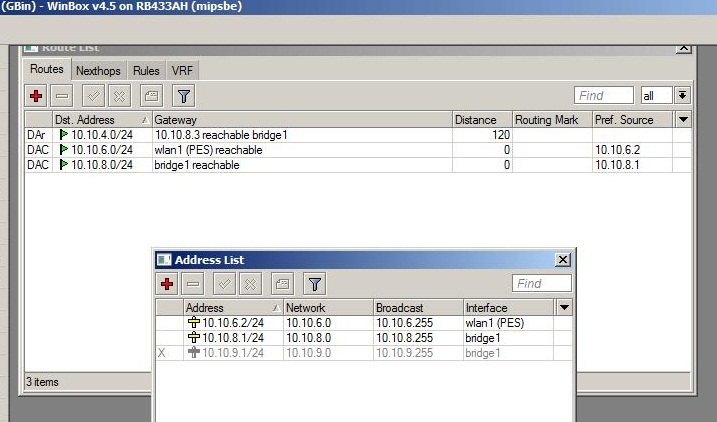

Here is the configuration to the Grain Bin in the neighboring town.
Right now there is communication from the Grain Bin to the PES tower 10.10.2.1, but I can not get the PES tower 10.10.2.1 to communicate with the Grain Bin. Since the Internet connection originates in the town where PES is located I need the PES tower to communication with the Grain Bin.

After a few seconds looking at that, I am concerned with some of the logic behind the routing.

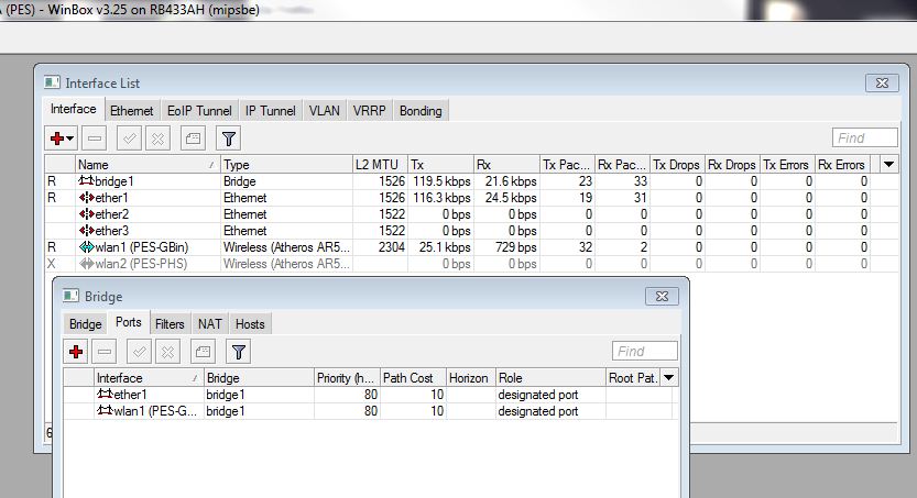

On PES 10.10.2.1 you have a default gateway (0.0.0.0/0) pointing at itself. It is also pointing to a bridged interface bridge1. Please list the ports that make up that bridge interface.
Also you state that from 10.10.2.1 it cannot communicate with 10.10.7.1. Well, looking at the routing table on PES, I can’t see how it will work. There is no route for any traffic destined for 10.10.7.1 to go anywhere as the default route (which would apply for 10.10.7.1) goes to the bridge1 interface. I am guessing there is a WDS link here and bridge1 is the default bridge interface for the WDS connection? In which case the network is a little mixed up with L2 bridging and L3 routing! But 10.10.7.1 is not on the L2 WDS bridge (assuming this is done with WDS) it is ether1 on the GrainBin, so that is probably why it fails. Can you ping 10.10.6.2 from PES? If the WDS link is up, you should be able to.
if you add a new static route at PES for 10.10.7.1 and pointing it to a gateway of bridge1, can you then ping from PES to GrainBin?
Here is the Bridge and Interface config for the PES tower. The IP address for the Ethernet the Grain Bin is 10.10.7.1. I used it more for a identifier in the previous post. I don’t know if it is relevant to the signal transfer. Communication is through the WLAN on the Grain Bin since it is sending the signal about 8 miles.

One other thing I noticed, why have you got the address 10.10.9.1/24 disabled on GBin?
