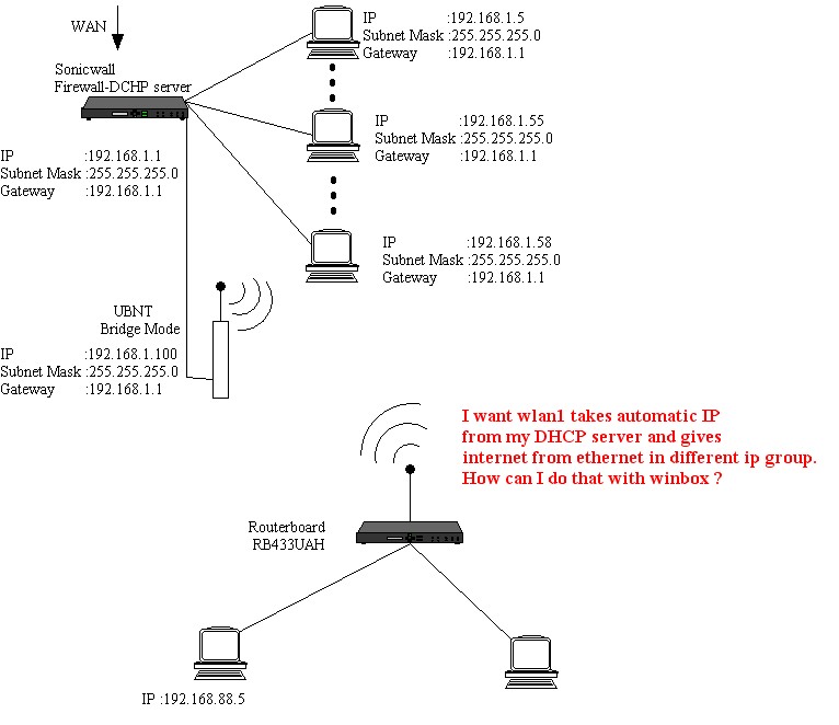

Hello all, I am very newbee at mikrotik. I have RB433UAH routerboard and need help about connection my existing network with wireless and distrubute it with ethernet. Here is the schema and scenario. My DHCP server gives static IP according to MAC addresses of devices. I set up DHCP server to give my routerboard wlan1 192.168.1.112 and I am trying to adjust routerboard gives internet by different IP group like as 192.168.88.x, how can I do that? NAT rules, RIP, DHCP Client… etc confused my mind. I read lots from http://wiki.mikrotik.com but it doesnot work. Can anybody help me about that with winbox ?
  1. Setup wlan1 (or whatever your wireless card is named) to connect up to the UBNT in station mode.
  2. Add a DHCP client to the wlan1 interface (via ip → dhcp-client)
  3. Add an IP address to ether1 (or whatever you lan interface is named)
  4. Add a DHCP server to your ether1 interface (via ip → dhcp-server → setup)
  5. Make sure you have a src-nat rule for traffic heading out the wlan1 interface:
Eg:
/ip firewall nat chain=srcnat out-interface=wlan1 action=masquerade
I see that my wlan1 connect to UBNT (my dhcp server) from its interface but I don’t have internet behind routerboard, where should I look for to solve that ?
And I also “/ip firewall nat chain=srcnat out-interface=wlan1 action=masquerade” cannot be writen to terminal.It says “syntax error”.What should I do ?
Sorry, I did it from memory and forgot the add command.
/ip firewall nat add chain=srcnat out-interface=wlan1 action=masquerade
That rule would be what you need to get access behind the routerboard, it allows the router to perform translation of the addresses on traffic coming in the ethernet interfaces heading out the other network that the wireless is connected to (because the upstream router doesn’t know about the lan network you have or how to route packets back to it).
