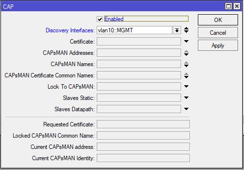

'wireless' doesnt exist in the WAP AX. In the Wifi tab i found the CAP button. I can enable CAP and i can set discovery-interfaces=vlan10-mgmt certificate=request. But i cant make out where to set interfaces=all?
Any clue here?

For the second part it looks like that Datapath and Coniguration first have to be set in Wifi. After that fact one can choose the made setting in Wifi1 and Wifi2. Although it seems to be like that?
Probably caused by a space...can you try again?
Certificate can be added later.

/interface wifi cap
set enabled=yes discovery-interfaces=vlan10-mgmt enabled=yes
We'll get there :slight_smile:
i changed the vlan10-mgmt in VLAN::MGMT as that is the name used in the earlier code. And i removed the second enabled=yes ?
So datapath and config remain as well as the certificates...
@erlinden: don't appoligize.. just look at my earlier posts... i am very grateful :slight_smile:
So i added the request, datapath and the config exactly as the website says and everything is working now!!!
