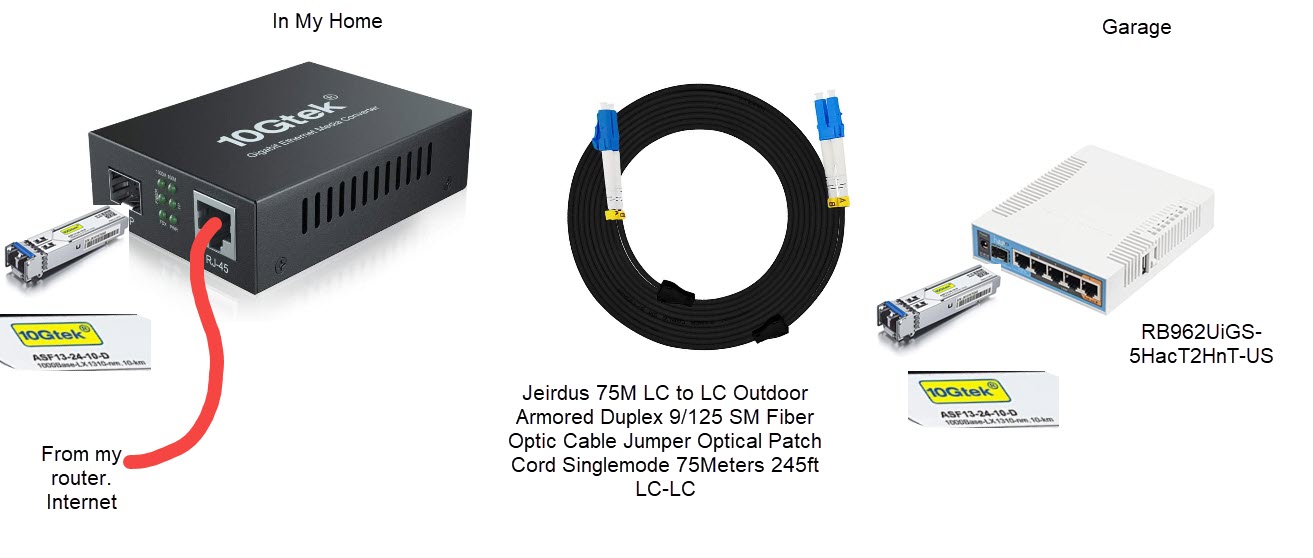

I am trying to connect my house network with my new detached garage. It was recommended I use fiber optics and use this RB962UiGS-5HacT2HnT-US Routerboard as a wireless access point in the garage. Being my first use of fiber I had hoped it would be plug-n-play. Not so far.

Finding another device (fiber, GBit-Switch and WiFi) for the same pricetag and consumer friendly is impossible, I think.
Your next best option (and using fiber link is the right way) is to get a second media converter and connect a consumer AP
That is exactly what I did. Thx!
