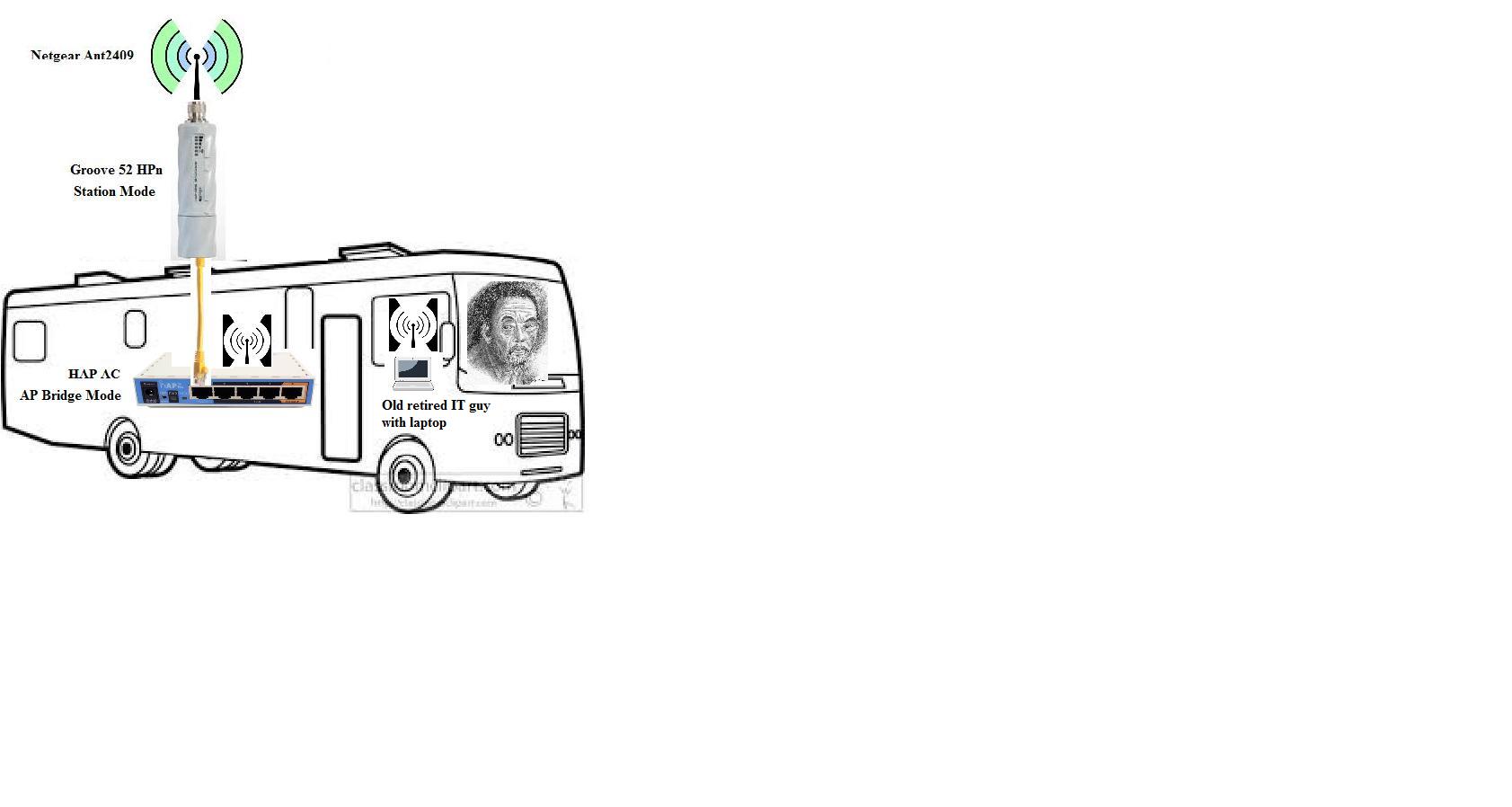

My challenge is to implement the most appropriate hardware and software solution to provide connection to campground/public wifi from my motorhome. Our itinerary is such that we move from one location to another almost daily. I am considering as a solution the combination of Groove 52 HPn and HAP ac. The Groove would be mounted with a 9db omni on a servo operated retractable mast atop the motorhome. The Groove would be I presume in Station mode. It is then connected via ethernet to a HAP ac inside the motorhome that I suppose would be in AP mode. The HAP ac provides wired and wireless connectivity for the clients. Is this an appropriate selection of hardware? Can you suggest more appropriate hardware? Is there a more appropriate software solution than RouterOS for this application? I must confess absolutely no experience with Mikrotik equipment. I was years ago a network administrator and have experience with Ubiquiti products. I am now a retired IT manager so I have a broad, if shallow, knowledge of all matters IT. Tell me, should I abandon the notion of growing my own solution and purchase a canned product like WifiRanger or some such? I am thankful for any guidance.
The hardware you’ve chosen sounds appropriate. Of course there’s plenty of ways to do it, but I think you’re on the right track.
I hadn’t seen WiFiRanger before, but it looks like it’s Mikrotik gear that’s pre-packaged and configured. If you’re comfortable configuring it yourself you’d save a bit by buying the individual components.
If you’ll be connecting it up to the park’s WiFi yourself, you shouldn’t have any trouble. If you want it to be simple so someone who doesn’t have an IT background can connect it up, you’ll either have to do a bit of work (WebFig skin, script or API call) to simplify it - looks like WiFiRanger has added their own web interface.

No reason for servo to turn around with omnidirectional antenna…
