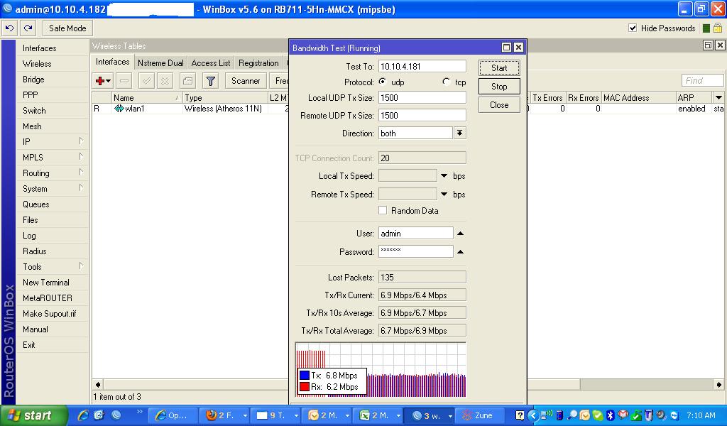

I have seen guys in Mikrotik post bandwidth test showing 35-40-80 mbps but I dunno even with full clear LOS and even with 711 connected ptp I was never able to throw more than 8/9 mbps tx/rx in udp in my bandwidth test.

If you are only able to produce 8/9mbps udp on a ptp link you really have a very problematic link. Give us some more details and we might be able to help you a bit on that.

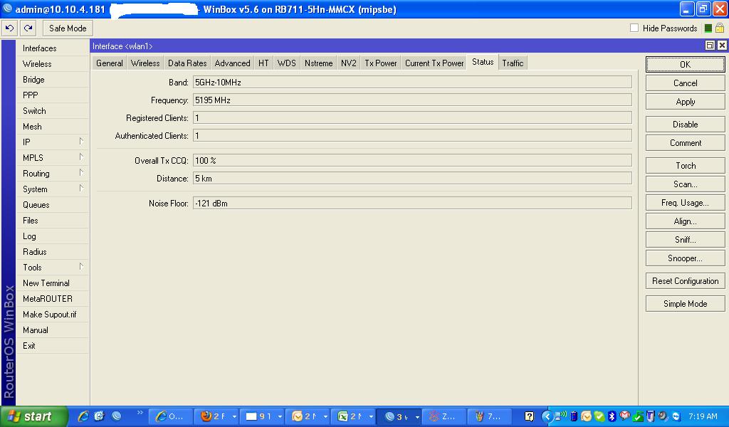

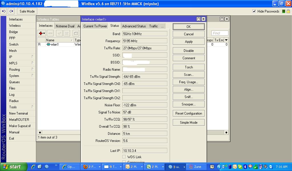

By nos. i mean 2 numbers. it is actually a ptmp link. with 711-A-5hn as AP and 7115hn and sxt clients.
I have another link that is 7115hn PtoP and i just get 8/9 mbps out of it. LOS is very clear and height is 110 ft at one end and 90 ft on the other end.
