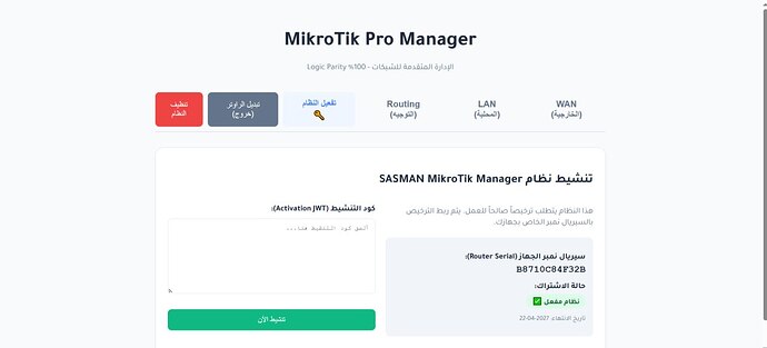

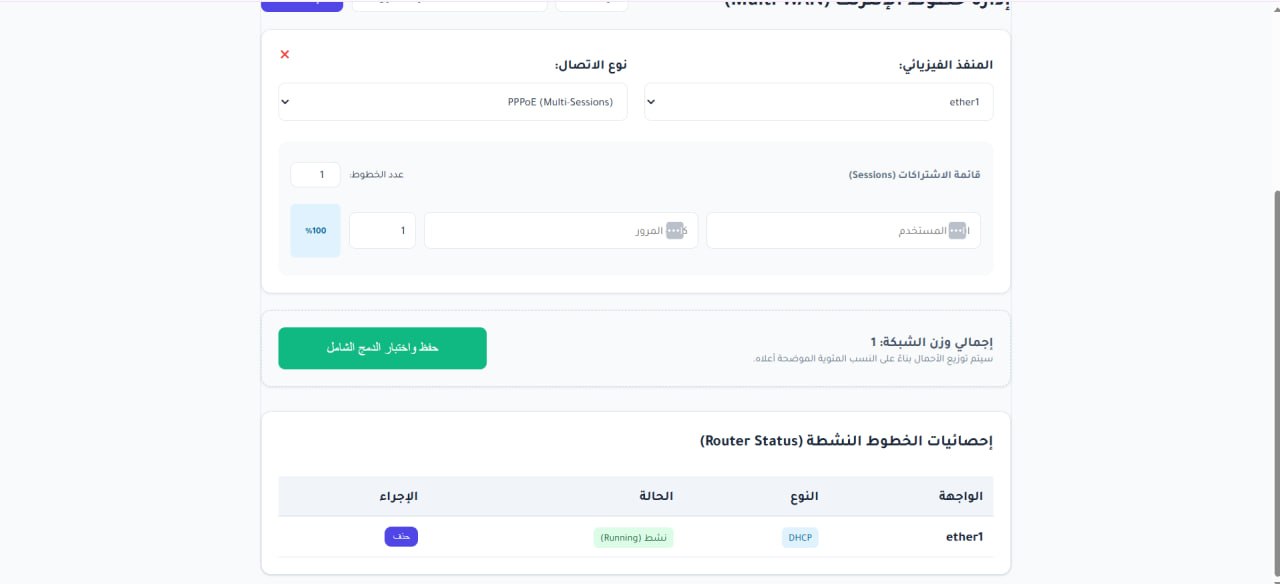

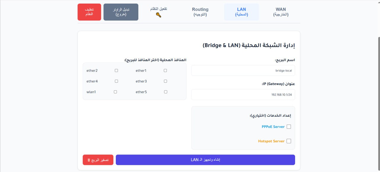

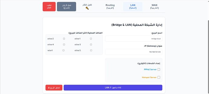

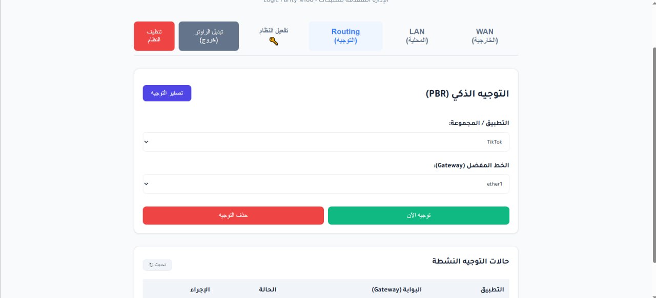

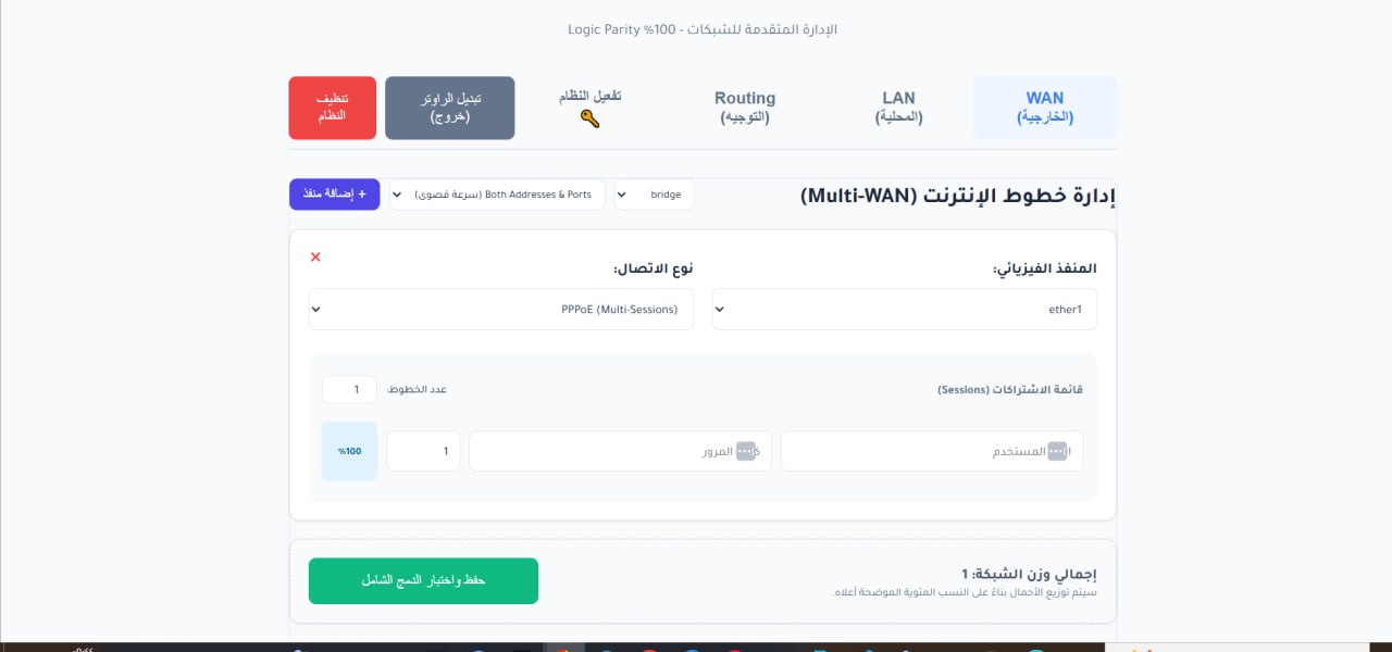

Have you tried accessing the RouterOS REST API from a container?
There's a first-party video on this topic.
Yes, I definitely created a container that works with MikroTik router settings. Yes, I definitely created a container that configures the MikroTik router settings.
It's hard to undersand what is shown on screenshots :frowning:
Yes, because the container is in Arabic.
That is obvious but not all know that language and it's not too easy to translate it to English.
