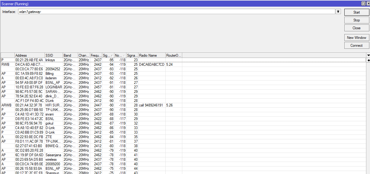

hi As per your reply iam attaching the details
the wireless card is single chain
we are using fixed wireless ie, Tplink 5210 & sxt2hnd
thew nearby frequency scan and wireless scan are attached

Still not a lot of info;
But I can already distill you are using 802.11 legacy mode (because different make devices) in a very congested spectrum (like 2,4Ghz usually is).
Meaning your AP’s network will suffer highly from interferences coming from all directions.
Having all 3 sectors connected to radio’s (use of channel 1, 6 and 11?) that are all in the same bridge with maybe some other network segments, means that ALL traffic from and to clients goes over ALL radio’s. This degrades the overall performance of your network a lot. A very slow connected client in sector A will bring capacity down of sector B & C too.
Still you didn’t answer my question about the ping time. Are you really referring to 3000ms? I would say 300 is what you mend to say. Still not very good but expectable in your setup…
I don’t know what area with how many users you’d like to reach but I would first of all take the 3 radio’s out of the bridge to block broadcasts between the 3, than make sure you use the 3 separate channels. You can also try to eliminate 802.11b users, they are a pain for the overall performance of your AP network.
Depending on the reach in distance and amount of users I also would look at prospect to degreasing my cell size and use more AP’s…
