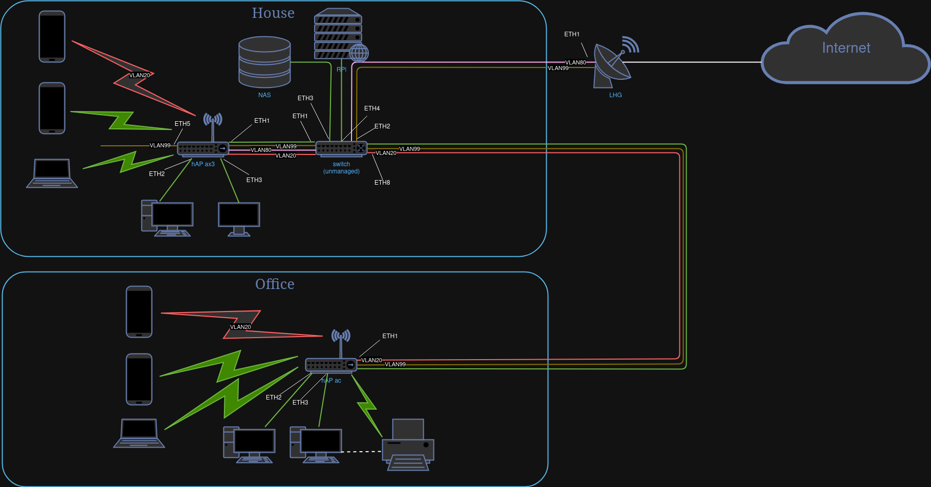

To get a picture of the more complete setup:
The difference with the image is that the switch is managed now, so there’s no untagged traffic any more, with green being vlan10-home now.
