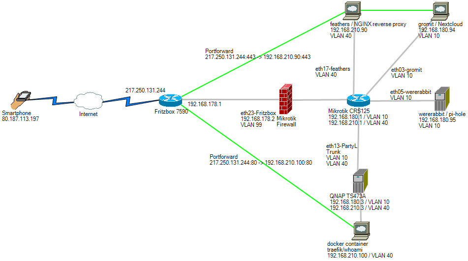

I have an issue accessing a webserver via CNAME while it works when using IP address.
I have a port forward on my Fritzbox from port 443 to my NGINX reverse proxy. This is the working production setting I use to reach my Nextcloud instance. My public IP (at time of writing = 217.250.131.244) is dynamic. A CNAME xxx.onthewifi.com (masked my actual CNAME with xxx) pointing to the public IP is registered at a DynDNS provider and it works perfect for the production setup, i.e. I can reach my Nextcloud by going to https://xxx.onthewifi.com/.
My intention is to move the reverse proxy and Nextcloud to a docker container inside a QNAP TS473A NAS. So I added for test purposes a second port forward on my Fritzbox from port 80 to a docker container running traefik/whoami (see https://github.com/traefik/whoami/).
The problem is that I can reach whoami at http://217.250.131.244/ from outside my network but it is not working when using http://xxx.onthewifi.com/. I get a timeout when I try going by CNAME.
This is the network topology:
This is the Mikrotik CRS125 config:

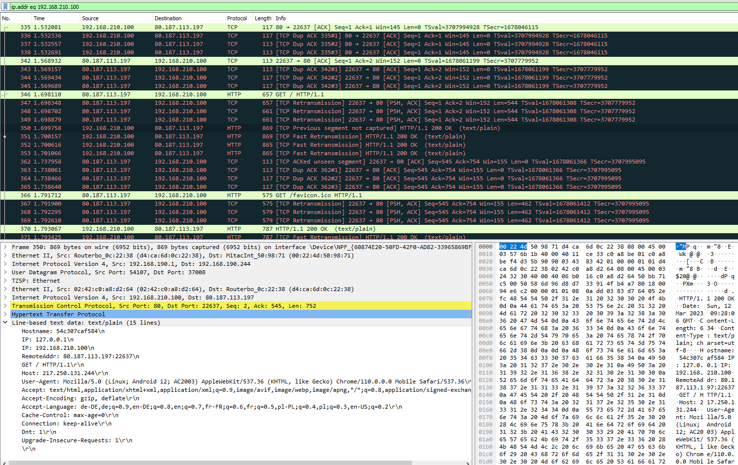

In order to better understand the problem, I have checked the firewall log. There are no packet drops / rejects when I load the URL. Next I tried to capture the network traffic with Packet Sniffer + Wireshark. I’m not a network expert and this is my first experience using Wireshark. I captured both attempts, first with IP:
Next with CNAME:
You can see that the first request via IP worked and whoami answered with some connection details. The second request with CNAME has no answer. The full Wireshark files are attached.
