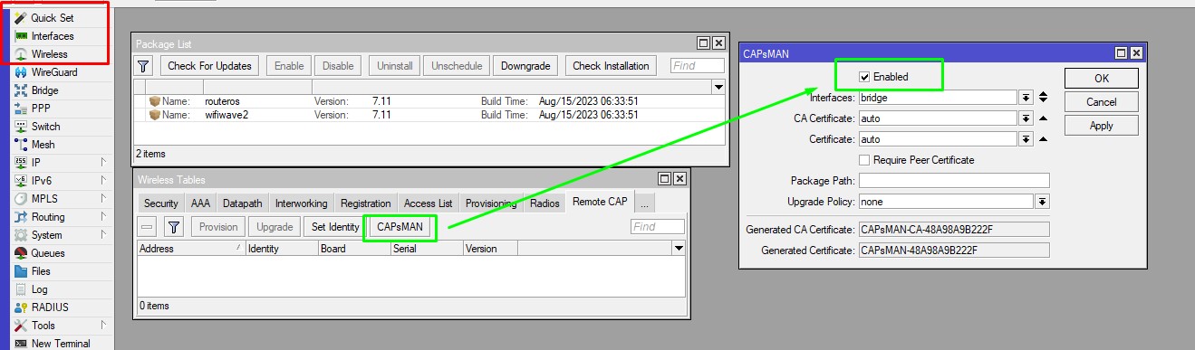

CAPsMAN: WinBox → Wireless → Last tap “Remote CAP” → Button CAPsMAN → Enabled

There is capsman button for devices with wifiwave2 package. See above pictures
