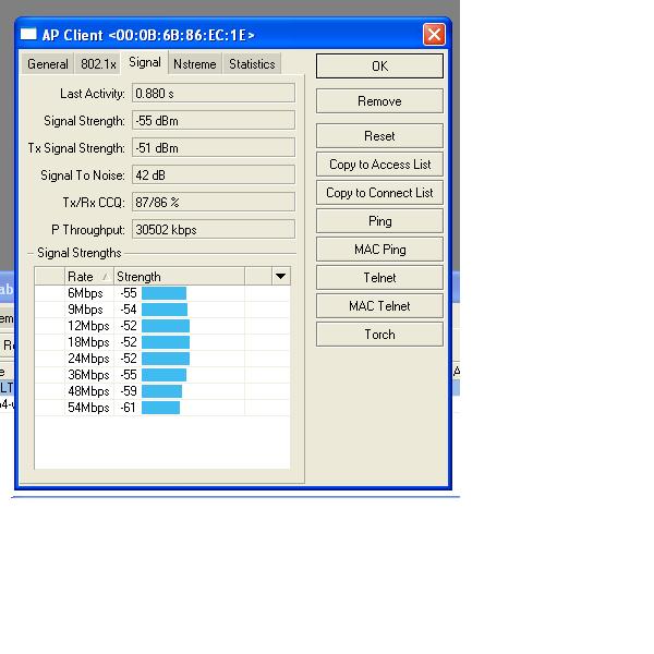

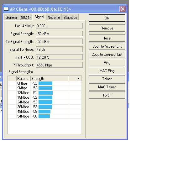

Today in the same link we substuite the minipci with AR5413 by one end and AR5413 by other and all tests very ok ccq 98%/98% and it not depending from the load of link. Tomorrow we tray to replace other mipci with critical link AR5212 with AR5413.
We attached the proof.

the same link, same antenna, same routerboard, but different mini pci
AR5006X 802.11abg NIC (rev: 1) with AR5212 802.11abg NIC (rev: 1) very bad ccq when loading the link
AR5212 802.11abg NIC (rev: 1) with AR5212 802.11abg NIC (rev: 1) very good link more than 20 Mbit/s

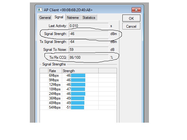

try to lower you output power on each end by 10db to try to get -60/-60 for signal strengths.
Your ccqs should go up.
attached signal strenght and ccq for about 1Mbps of load.

tx of -64 is OK.
the other end has to have its power lowered also, rx of -46 is too strong.
