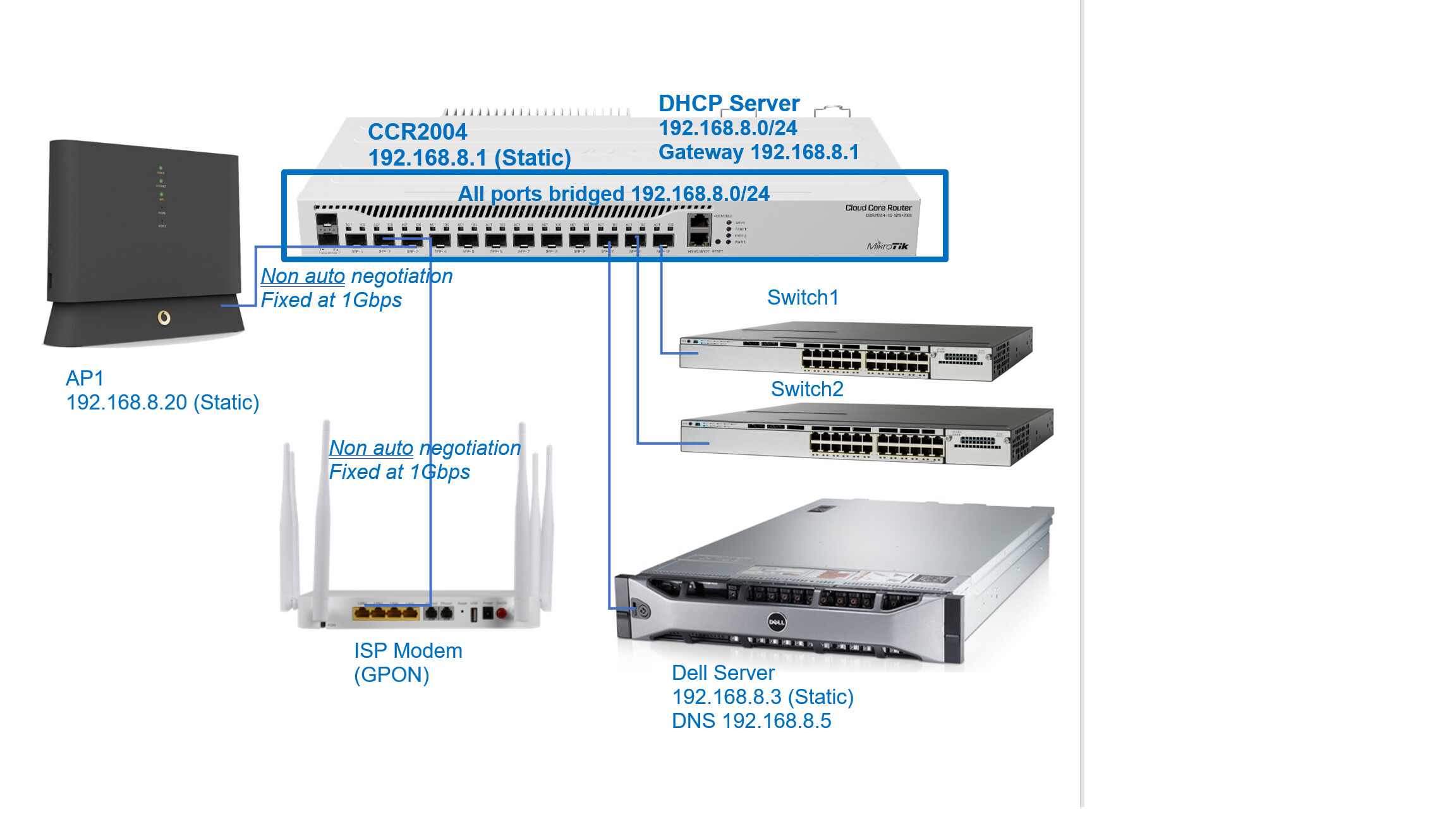

Probably but how can I best investigate the issues… Crystal ball, tarot cards, speculating…
OR
post network diagram
and
/export config (minus public WANIP info)
Thanks for your reply.
Attached the diagram.

Did you set the IP address manually in the MT.
Go to DHCP leases add the ip address and the mac address of the AP. not much else I can think of.
Hi Anav,
I added the mac of 2 APs, and things seem working for now.
I’m thankful for your patience and help.
PS: the two addresses I added are in “waiting” statut, I don’t know if does matter …
