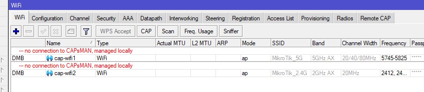

no connection to CAPsMAN, managed locally
HI!
I started upgrading my home network and switching to MikroTik devices. RB5009 as router - great piece of hardware. Few days ago I bought first new AP - cAP ax to test and try new configurations before I buy another APs.
To the point - My problem is similar to his guy here: http://forum.mikrotik.com/t/wifiwave2-no-connection-to-capsman/170201/1
I cant get rid of the message “no connection to CAPsMAN, managed locally” on my rb5009 which is CAPsMAN controller. cAP receives configuration form controller without any issues, wifi works as it should but I don’t know what is the reason of that message.
What I tried to do:
  • resetting the cAP the way it is mentioned in linked thread but it didn’t help
  • specifying controller IP in CAP settings
  • manual cAP configuration
  • resetting rb5009 to default conf and connecting cAP
Can you take a look at my configurations and tell me what’s wrong?

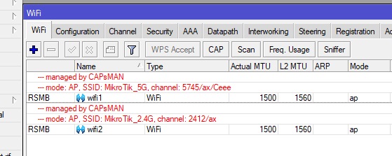

cAP conf:
/interface bridge add admin-mac="**" auto-mac=no comment=defconf name=bridgeLocal
/interface wifi datapath add bridge=bridgeLocal comment=defconf disabled=no name=capdp
/interface wifi
# managed by CAPsMAN
# mode: AP, SSID: MikroTik_5G, channel: 5745/ax/Ceee
set [ find default-name=wifi1 ] configuration.manager=capsman datapath=capdp disabled=no
/interface wifi
# mode: AP, SSID: MikroTik_2.4G, channel: 2412/ax
set [ find default-name=wifi2 ] configuration.manager=capsman datapath=capdp disabled=no
/interface bridge port add bridge=bridgeLocal comment=defconf interface=ether1
/interface bridge port add bridge=bridgeLocal comment=defconf interface=ether2
/interface wifi cap set discovery-interfaces=bridgeLocal enabled=yes slaves-datapath=capdp
/ip dhcp-client add comment=defconf interface=bridgeLocal
/system clock set time-zone-name=Europe/Warsaw
/system note set show-at-login=no
/system routerboard settings set auto-upgrade=yes
You missed configuring the local wifi on RB5009 as a CAP.
/interface wifi cap set …
You don’t have to set manager in the router’s configurations. Only on cap.
OP:
you did not show it but I’m guessing you are using 7.13 or higher on that RB5009 ?
You do NOT need wifi-qcom package on RB5009. Remove it if it is present.
Basic functions to act as capsman controller are present in base ROS package as of 7.13.

I have you identical problem, have you resolved ?
I’ve been having the same problem, but I think i found an answer: “configuration.manager should only be set on the CAP device itself, don’t pass it to the CAP or configuration profile that you provision.” (from the docs) https://help.mikrotik.com/docs/display/ROS/WiFi#WiFi-WiFiCAPsMAN
It’s kinda mentioning ax2 and ax3, but my guess it should be the same for cap ax as well, at least it working on my both ax2
