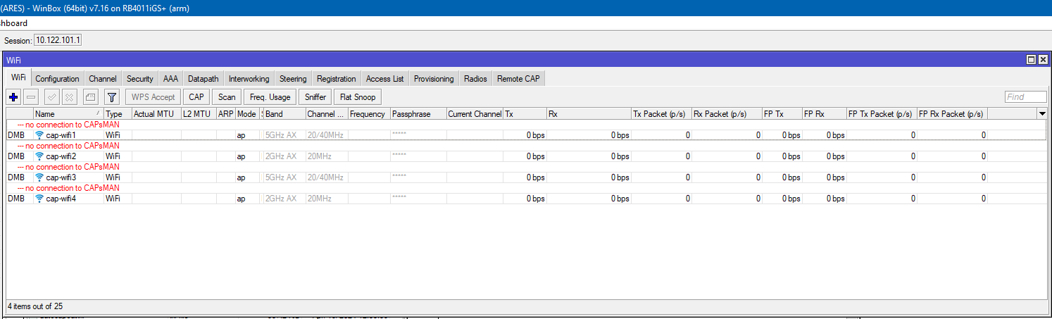

Despite the fact that the access points say “managed by CAPsMAN” the RB4011 itself states “no connection to CAPsMAN” over the interfaces.
Pinging the CAPsMAN from any of the access points works fine and vice versa.
All of the devices run the latest RouterOS 7.16
It almost looks like a bug as "no connection to CAPsMAN normally only shows up on the CAPs when the CAPsMAN is offline

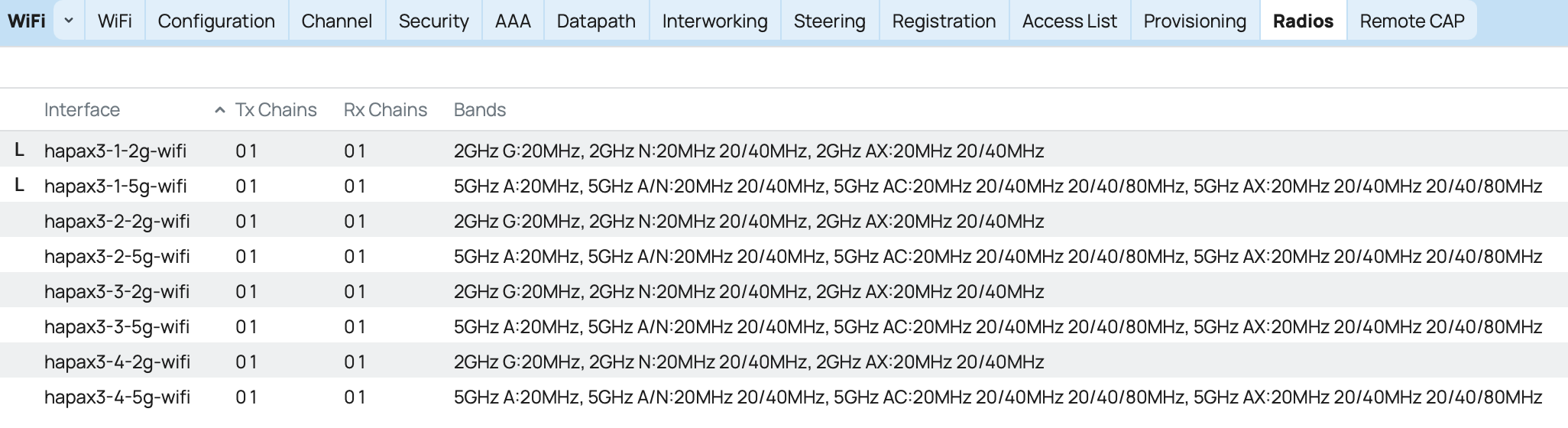

The interfaces are showing up as L for local …
It’s a bit misleading since the same screens are used for local and capsman controlled interfaces.
The ones marked with L should be locally managed since MT themselves clearly mentioned capsman CAN NOT control local interfaces.
What is indicated as manager on those 2 radios marked with L ? My guess is local or capsman-or-local. And then local it will be.
Or look on the device itself on Wifi tab. It will indicate there what is managing those radios.

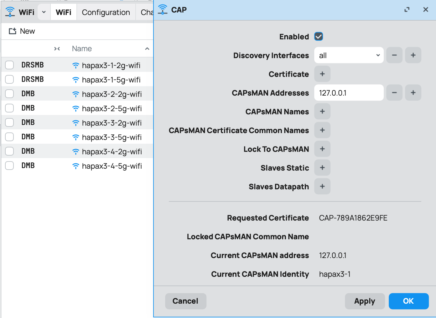

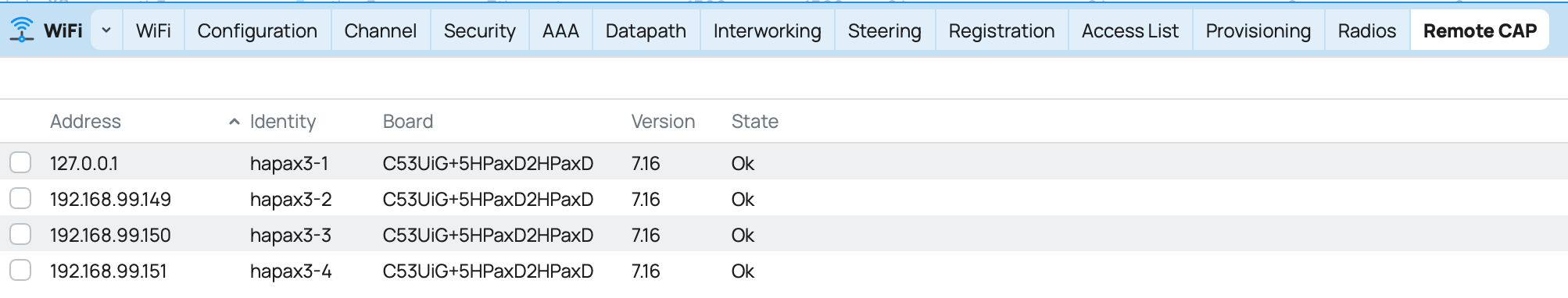

I added the local machine as CAP to the CAPsMAN …
This worked ONLY if 127.0.0.1 as CAPsMAN addres was used.
From that point on the interface wher part of the CAPsMAN interfaces

And what is the benefit?
all devices are in the same steering group now
You don’t need to do that for steering group. You should just apply created configuration profile to local interface and thats it. Local interfaces will be in same steering group as the virtual one created by CAPsMAN.
