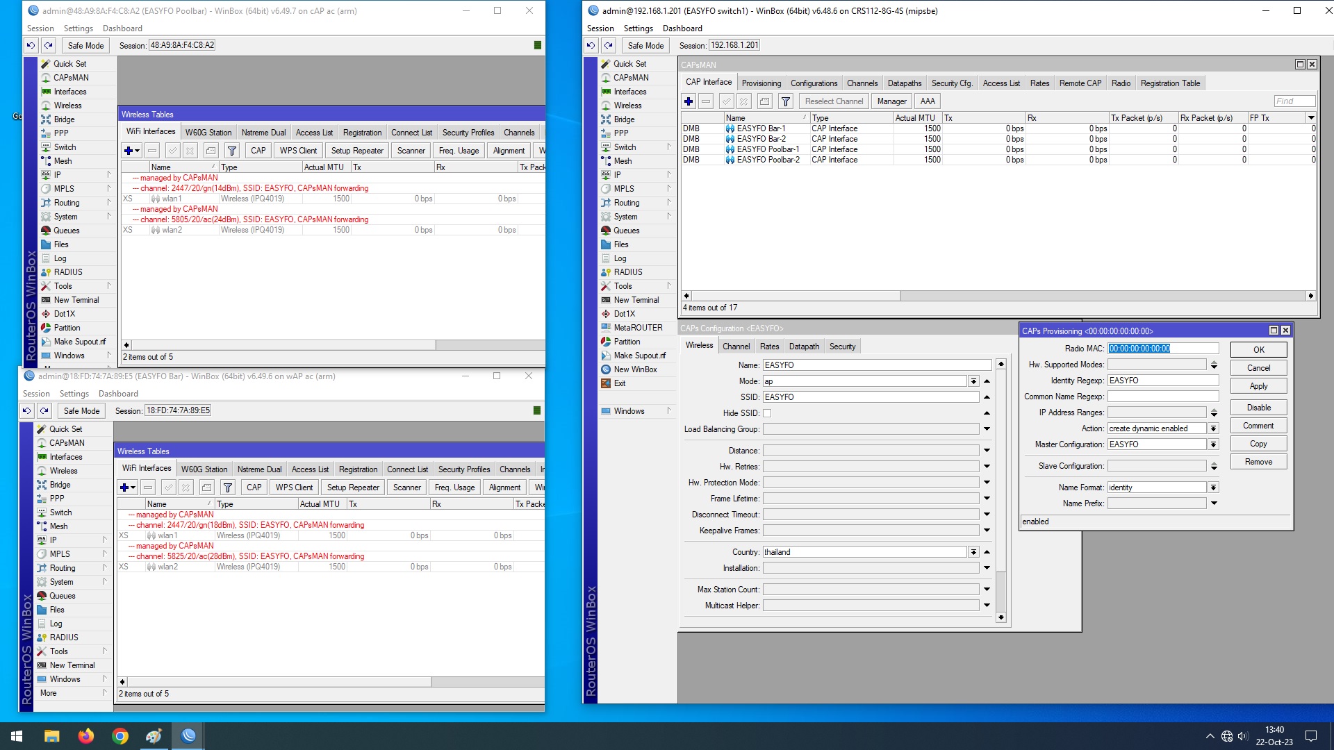

OK. So I have reconfigured all units from scratch. Also reconnecting the hardware so it now is:
CRS112 - Switch1 with DHCP server and CAPSman controller. Fixed IP
CRS112 - Switch2 for pass through traffic only. Fixed IP
cAPac - Connected to Switch1. No IP, CAPSman client
wAPac - Connected to Switch2. No IP, CAPSman client
The SSID is visible in the network and the CAPSman client shows in the AP’s interface list fbut still no IP when trying to connect. Tried both secured and open options. No difference
If I remove the CAPSman client from one of the AP’s and set up a standard SSID I get IP and can manage the network units in WinBox
The CAPSman client connects to the manager if I have “Bridge” as discovery interface. Ethernet1 does not connect. Interfaces are wlan1&2
All ports are in the bridge.
Attached are the settings used now plus screenshot of settings in Switch1 and AP’s
