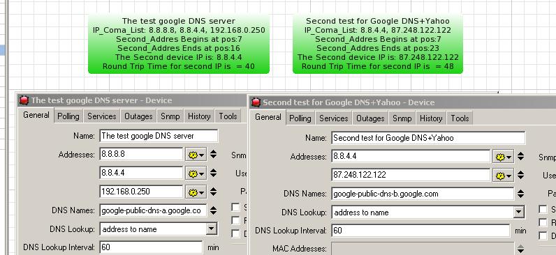

I had solution for a such probe.
All you have to do is to use functions to get second IP address and to ping it.
Look at the picture
the device label is
[Device.Name]
IP_Coma_List: [Device.AddressesCommaList]
Second_Addres Begins at pos:[Second_IP_Beg()]
Second_Addres Ends at pos:[Second_IP_End()]
The Second device IP is:[Second_IP()]
Round Trip Time for second IP is = [Ping_Second_IP()]
[device_performance()][Device.ServicesDown]

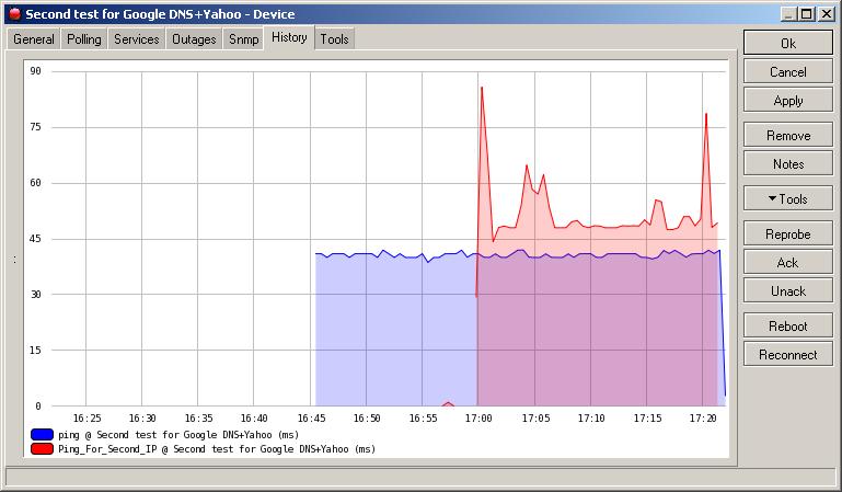

And finaly the history picture
