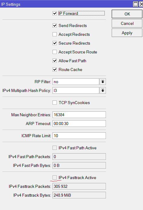

Set up new HAP AX2 with same config as RB4011 & rb750gr3.
No wireless package, only ROS 7.16.1 installed.
Traffic processed between ethernet port 1 & 2.
Faced with strange issues with firewall fasttrack rule and finally disabled it.
Without firewall fasttrack rule everything works fine.
Noticed there is “IPv4 Fasttrack Active” always disabled which is different comparing to RB4011 or rb750gr3. (see pic below).
Is it due to Fasttrack is unsupported with HAP AX2?
Or I can thange something to enable for ethernet ports ?

enabling\disabling fasttrack rule , makes no effect on that status, “IPv4 Fasttrack Active” always disabled - pic above.
Am I right that its due to no support of ethernet fasttrack on HAP AX2?
https://wiki.mikrotik.com/Manual:IP/Fasttrack
Quote: “All devices wireless interfaces, if wireless-fp, wireless-cm2, wireless-rep or wireless (starting from 6.37) package used”
My guess - there no support for ethernet ports on this device.
Only wifi interfaces when wifi package is present.

But again, no effect to “IPv4 Fasttrack Active” - always disabled

Enabling\disabling this rule obviously produces no effect to “IPv4 Fasttrack Active” - always disabled.
