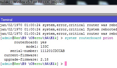

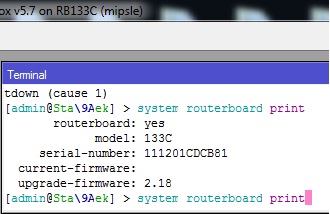

I have the same issue with severals rb133c. RouterOS 5.7 but current firmware EMPTY. In log can see router was rebooted because kernel failure
After
/system routerboard upgrade
There is current firmware 2.18, but after 1day is there again current firmware EMPTY and kernel failure

After /system/routerboard/upgrade the firmware was 2.18 on one device, but after second running the command, firmware is 2.38 now. No reboot with v5.7 since then, but its running only for a few days/weeks.
